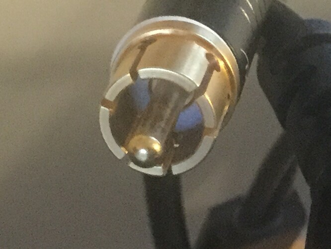

I have had one slightly slack RCA on my Superlumina RCA to DIN cable. The Naim RCA is very thick so it is not easy to make it grip tighter. Whilst the signals are not as small on the output as from the cartridge, suggestions on tightening the fit very welcome.

Is it the SL DIN that’s loose, or is it the socket? Maybe worth trying it in some different sockets to make sure.

Thanks for replying. Definitely the RCA as if I reverse them it’s loose on the other socket. It been loose on Rega Auras when I had demoed.

The rega phono cables come with phono ends that you turn and they then squeeze the outer barrel. You need to unscrew them to fit and remove and then once fitted screw them tight.
I didn’t realise this was the case with my P8 and couldn’t get them on my superline and so used the the other connections, until i found that they unscrewed and guess what they fitted fine then. O well as they say.
