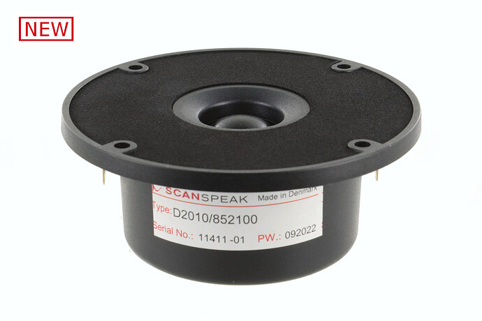

From a certain website :
After almost 5 decades of service the highly praised D2010/851100 were upgraded to D2010/852100 with modern materials and to new manufacturing standards, still maintaining its excellent performance as wide dispersion, smooth frequency response and natural sound character.

Can these tweeters be easily opened up and a new new dome/voice coil installed?
I guess probably not, but it’s nice to know of the new 852100 version.

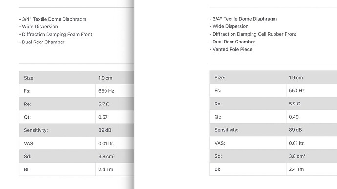

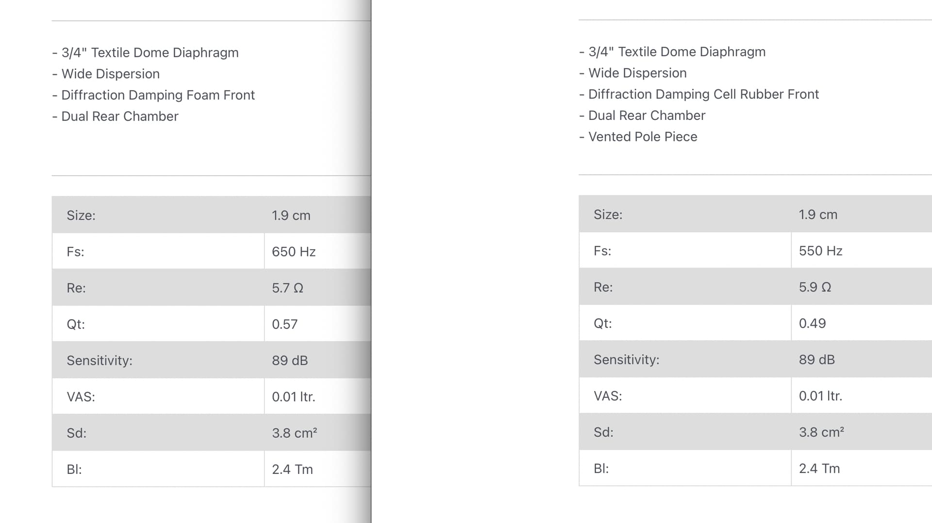

The new ones are a little different…
Yes, they are a little different but I wouldn’t be afraid to use them as they have the same sensitivity and a even lower free air resonant frequency.
They require 4 holes though instead of 3 for the screws

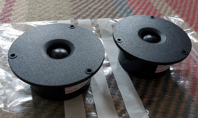

The D2008/8512 have three holes… So the SBLs and IBLs should have D2008 tweeters and the DBLs, NBLs and SL2 have D2010s.
Ordered these for my iBLs from Falcon Acoustics on Sunday, arrived here by courier Wednesday. The tweeters were well packed with bagged individual boxes, placed in a larger box with foam chips. I need to get some unleaded solder, and because of my busy schedule I hope to install them next week.
