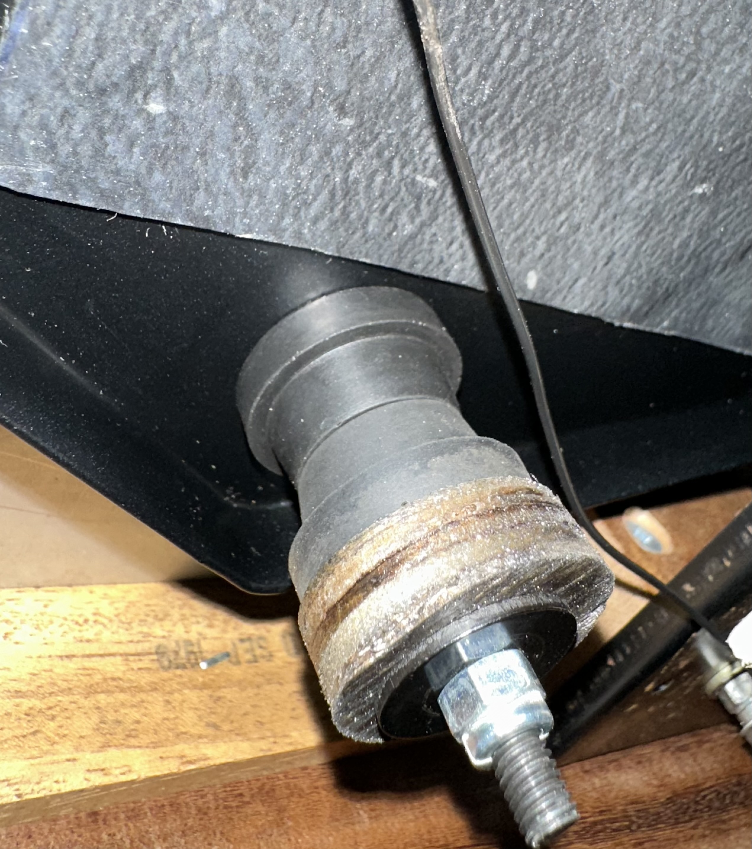

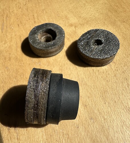

Yeah I’ve been interested in trying the ‘mushrooms’, mainly just to see if it was yet another ‘swings and roundabouts’ fad. This one promised better pitch stability, but at what cost elsewhere? I thought I’d start by trying my own version, which cost me nothing apart from an hour in the workshop. Basically I removed the bottom small grommets and springs, then fitted an additional inverted large grommet, with a machined plywood adaptor to retain the extra grommet. Pics below should make sense hopefully.
What has surprised me is that everything about the sound has improved, not just pitch stability- which has remarkably improved PR&T.

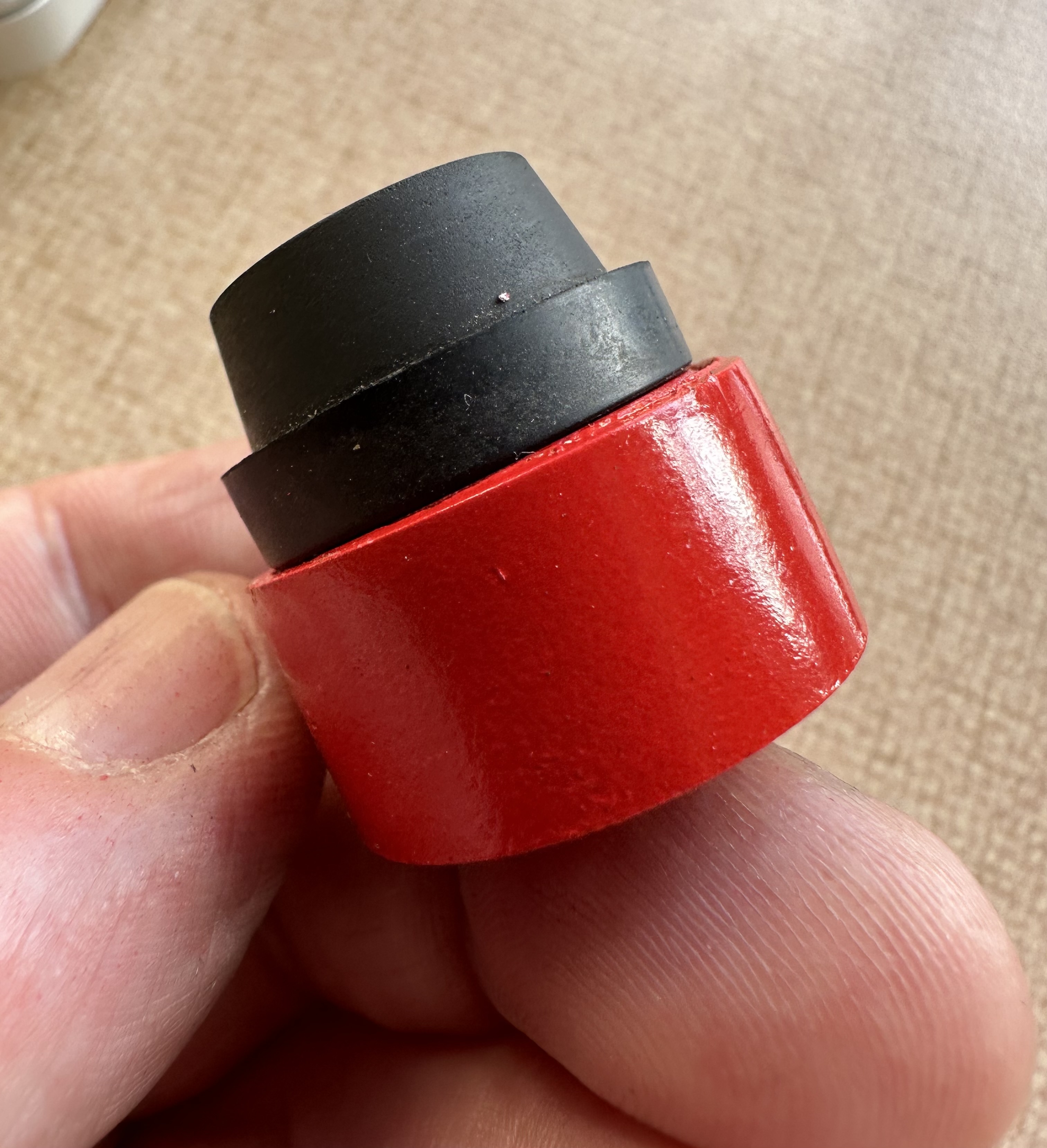

Initial results very positive but wanted to try some alternative grommet adaptors - these ones are all metal construction. Will now leave everything as is for at least a month to see if it still pleases.

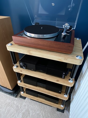

Wide angle view on an i-Phone does some strange things to straight lines, anyway this is the new setup;
Linn LP12 - Selekt level minus cartridge
Naim - NSC 222 / NPX 300 / NAP 250
Speakers - currently dealers Kudos Super 20a’s on loan but 99.9% certain this is what I will be ordering
Cartridge for LP12 is Hana MH through 222
Cables are Naim from start to finish
Other than speakers and cartridge which will be new the rest is completely ex-demo and bought with some excellent savings, I could not have bought this setup at full retail.
My plan is to sit back listen and enjoy this as it is for the next 6 months or so whilst I decide whether to stick with top line MM or MCHO cartridges or look to add in a phono stage and go MCLO cartridge. No rush as what I have now has blown the old P3 setup out of the window and is totally absorbing.
