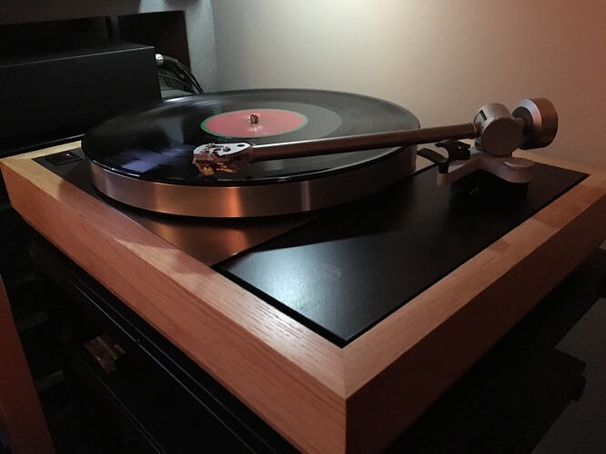

Drop dead gorgeous…if I was to build another LP12 your plinth would be the one for me.
ATB,
Mark
That’s clearly a Linn arm, but which model, and is it a special finish?
It looks great, in any event.
Its an Ekos SE (just magnify the photos) very nice arm indeed. I don’t know how to tell the difference between SE 1 and 2, but @Toon will confirm, I’m sure. It certainly is a beautiful plinth.
Apologies @Richard.Dane,
You are correct. The thread I was hoping to pick up on was the Solstice one & I got confused because the last couple of posts I remembered mentioned the LP12. Embarrassingly, I even wrote one of them!
Sorry for wasting your time.

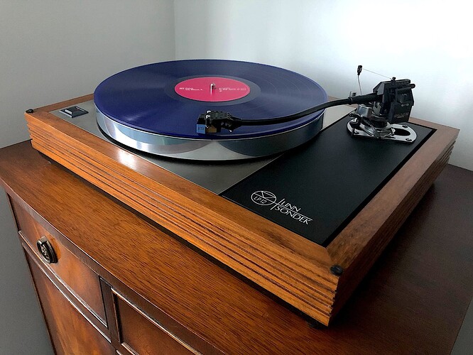

A quick pic of my main Sondek.
Its fairly average in spec but does sound nice… Valhalla (upgraded by VP) SME iii and currently an old A&R cartridge whilst Im waiting for Jico stylus to arrive for my Shure. Anyway, hope you like?

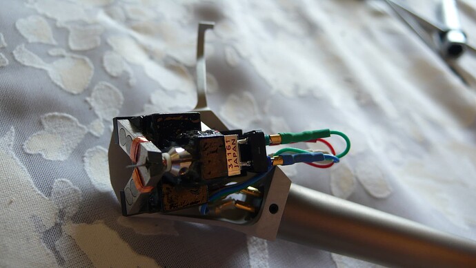

The preload for the Ekos SE/0 (Ekos SE) was introduced around S/n 11040 ( Dec 2008) So the later SE/0s do feature pre-load for the anti-skate and so after this time point in time and later serial Nos it was no longer necessary to dial up an extra 0.2-0.3 of anti-skate to get optimum performance.
As for the introduction of the larger headshell and heavy counterweight option, they became available in July 2012 around S/n 11540.

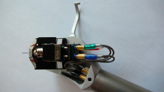

The picture said it all at that time… Both Left +ve (white) and left _ve (blue) tag wires were within the width of a fag paper of shorting on the rear of the headshell when the cartridge was correctly aligned!
KR
Peter
The same XV1 type Dynavector mounted in the new enlarged headshell and the problem was eliminated

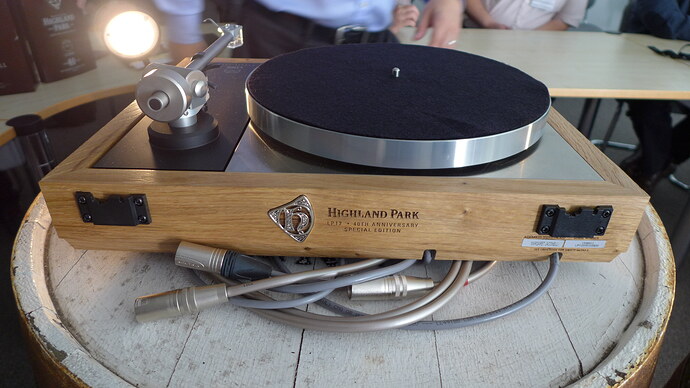

Blackstar, I remember my visit well. Over 8 years ago now… September 2013.
The deck was presented to us mounted on a cask but thankfully not played on one! :joy:
A very good event and well attended… Of course the offer of a drink (Highland Park) may have swelled
the numbers. Ivor was on good form too :slight_smile:
