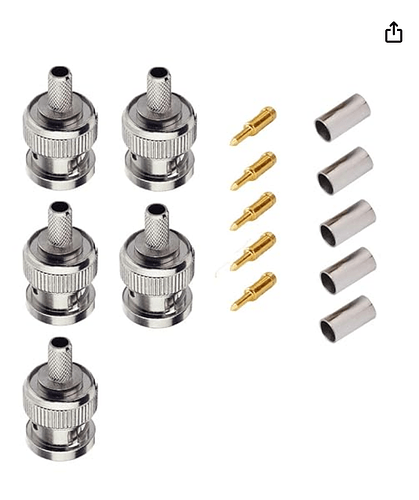

Is there anything special about the Tom Tom BNCs? Amazon sells nickel plated 50ohm BNC connectors.

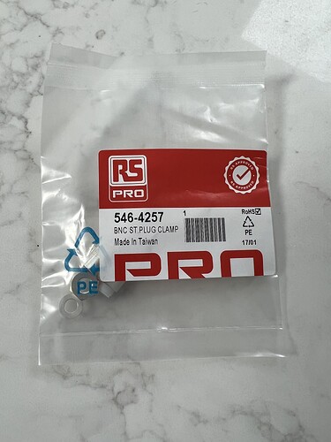

Notice the central pin on the Amazon BNCs. I fitted similar ones as a dummy run to determine whether to fully shield or leave the BNC side floating. The Naim recommended ones definitely sound better. I will post a pic of the packet that they came in. Maybe you can buy from RS direct.
Thanks… found them on the RS website.
