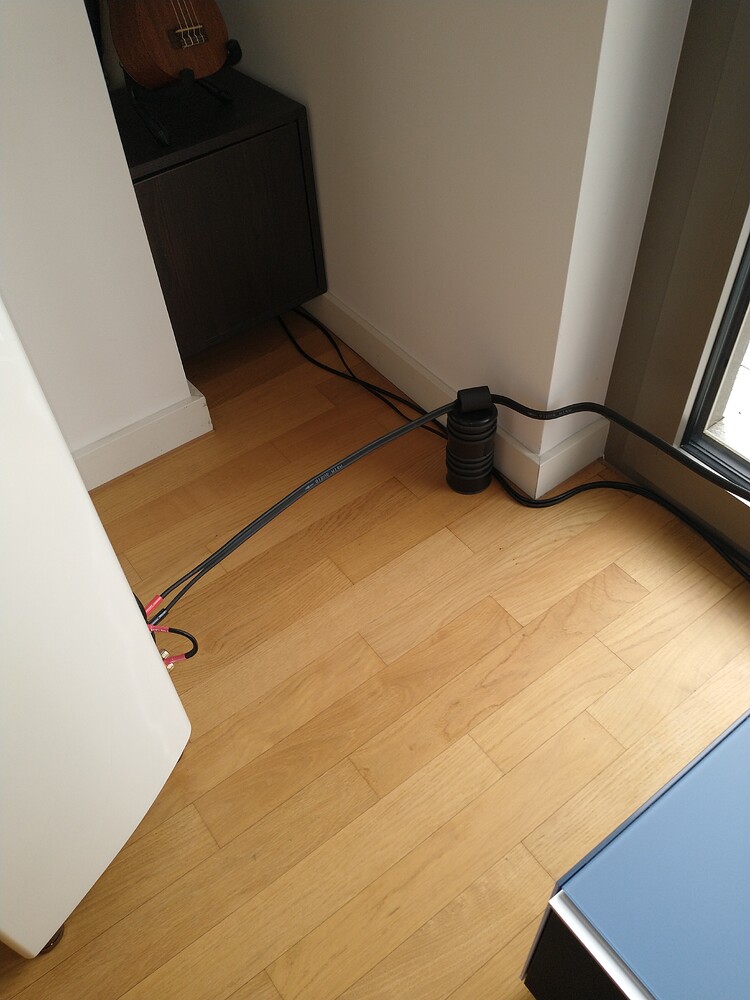

Chord don’t publish specs but I measured mine & found they are 0.6uH/m.
If you do want to have the recommended Naim minimum inductance load, then you need 5.5 metres per side.
