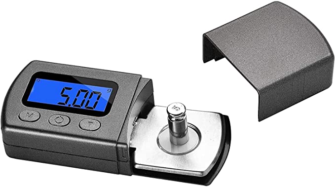

I can see on Amazon the Digitnow, for 12,99 euros. What do you think of that one. Or any other recommendations, on Amazon, for stylus force gauge in the max 20 euros price ?
The Digitone, picture from Amazon :
They come from many brands and are just fine. I suppose that given the price there will be the odd dodgy one, but they come with a 5g calibration weight like in your picture, so easy to check. I already owned the same one, but after all the spending on the new system I didn’t want to skimp on the gauge, so bought the Rega for 250 or so. Only the best for my P10! Both gauges showed the absolute same value. 250 eur well spent! :joy:

I have one of those and it works just fine. My Ittok with the dial set to 2.0 is actually 1.99g :grinning:
It’s very consistent too and easily checked with the included calibration weight.
I have one very similar, these are fine to a point, but they can give different weight reading sometimes, just by lifting the arm and lowering it again.

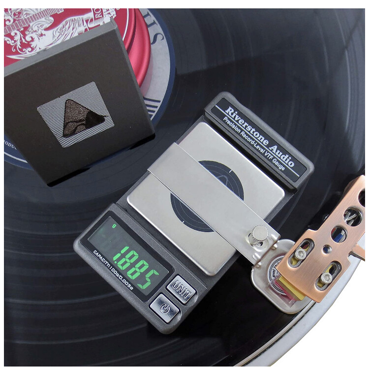

I have the same gauge you are referring to and others. But I prefer the riverstone as shown. Closer tolerance, repeatable, and checked with several weights, provides a more accurate reading.
Scott
+1 for the Riverstone. It’s currently $30 on the river, compared to around $15 for the one in the OP’s photo. Well worth the extra, especially as there isn’t much else until you get to several hundred dollars for the likes of the Clearaudio Weight Watcher et al.

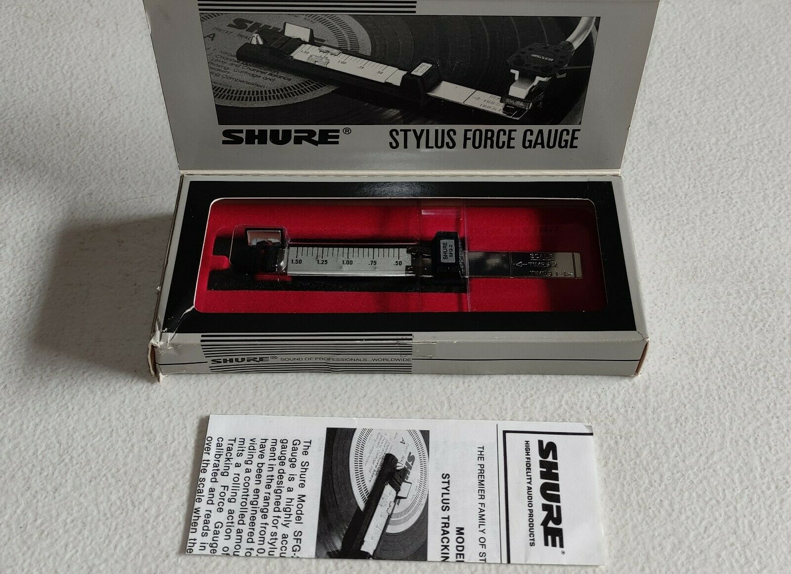

There’s also the Shure one. It’s often cited in forums. Apparently often used. It looks different. Not digital ?

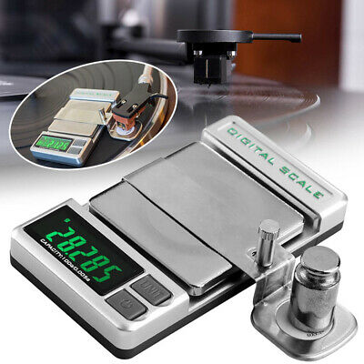

And I ordered another one, similar to yours, precise with 0,001 accuracy, from Hong Kong. Both costs around 15 euros. This second one will be delivered in one month.

I have three stylus force gauges. These are the one supplied with the Aro tone arm, the Shure balance shown above and one of the cheap digital ones shown at the top of this thread.
That supplied with the Aro cannot be used because it’s too tight. The Shure balance is OK, but when trying to measure ~1.75g you need to double the number shown on the scale and the intervals are rather large. Ultimately the cheap and cheerful digital balance is the one I use. I suggest you buy some fresh batteries for it as those supplied with mine didn’t last very long at all.
