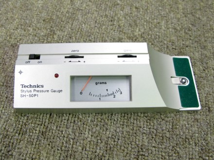

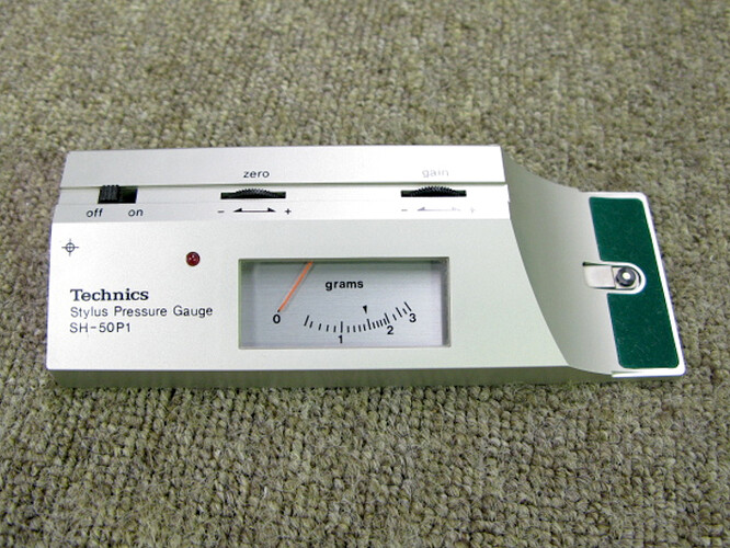

You’ll be wanting one of these..
A Technics SH-50P1 Stylus Pressure Gauge.
Good enough to be used by Naim for setting up Aros prior to testing during production.
I use one too, and it’s a delight in every way.

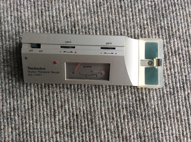

If you are on the lookout for one, make sure it comes with the plastic cover for the weighing end - this also holds the little calibration weight, which is essential.

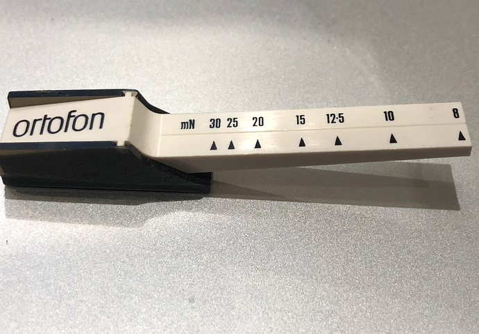

Ortofon balance for me !

I’m with @Richard.Dane here, the Technics is a joy to use.
If you are buying used, look for the little weight on the right side of the picture. Otherwise the gauge is nearly useless.

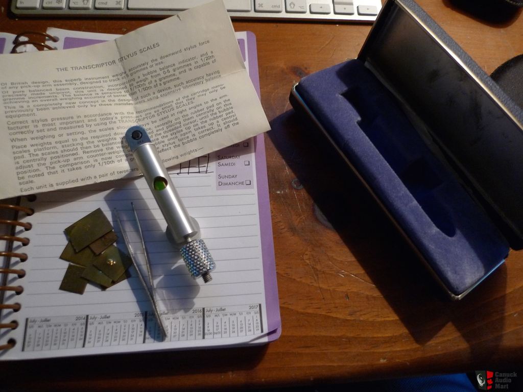

I also still have my Transcriptors Stylus Pressure Scales which I purchased in the early 70s as a manual backup.

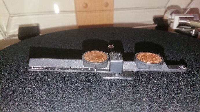

I still use this, that I got for free with Hi-fi Review magazine many years ago:
It’s good enough for initial setup, which I then refine by ear.
