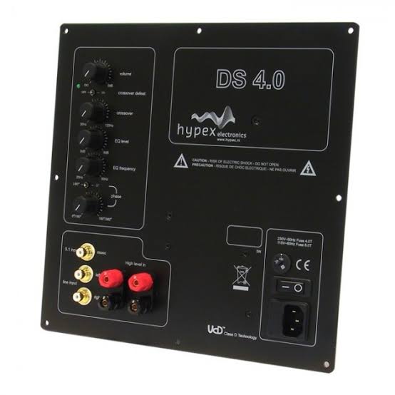

I have tried both ways in my setup and to my ears the high level inputs on my subwoofer amplifier -( a Hypex DS4.0 isn’t too bad ) …sounds better…

Hi @Xanthe
SN2 sub out to Hypex Low level inputs by stereo RCA cable…

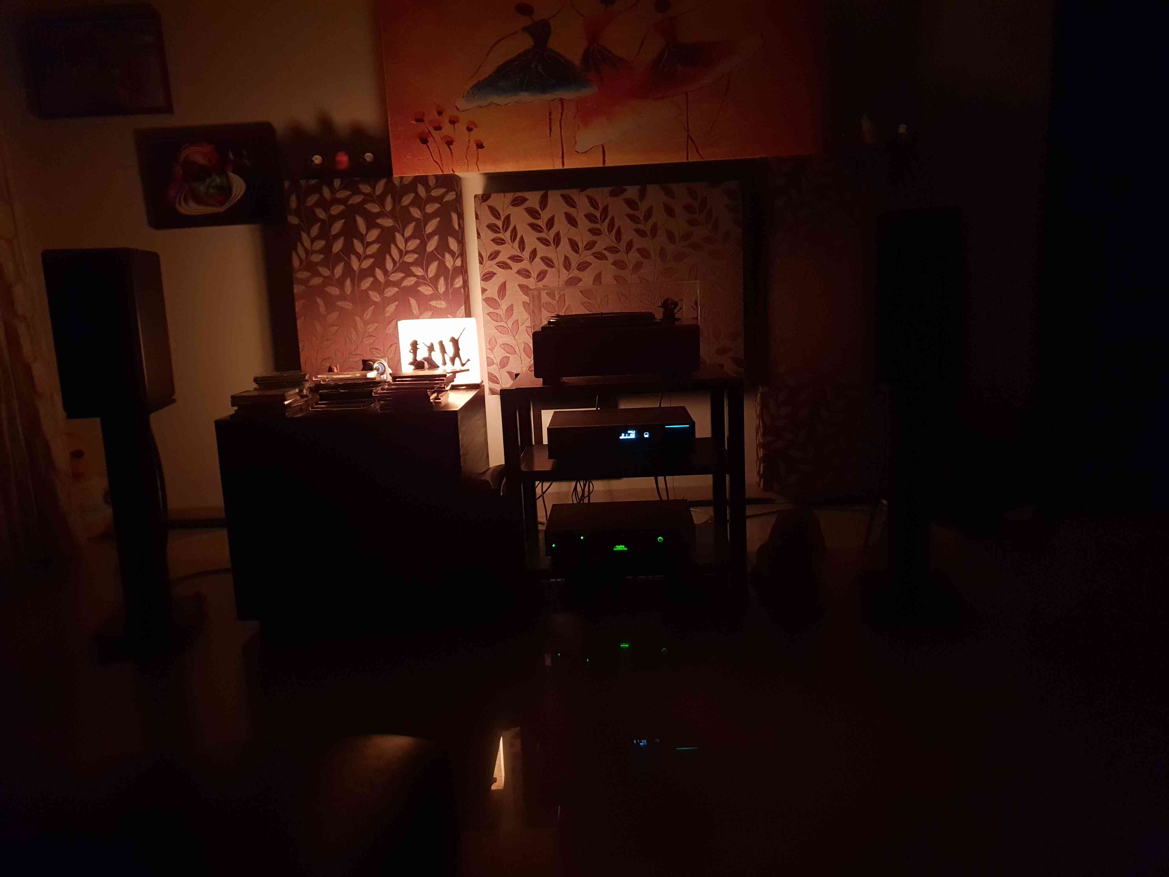

A pic of my setup…taken now..
The silhouette of the 18 inch sub can be made out.
It appears to be a similar distance from the listening position as are the main speakers.
How did you determine the group delay for the sub and (since you haven’t compensated for it acoustically using the sub’s position) how did you include that delay in the feed to the main speakers?
If you haven’t done this then the sub won’t be time aligned and all high/low level arguments are moot as the sub’s crossover isn’t properly integrated anyway!
