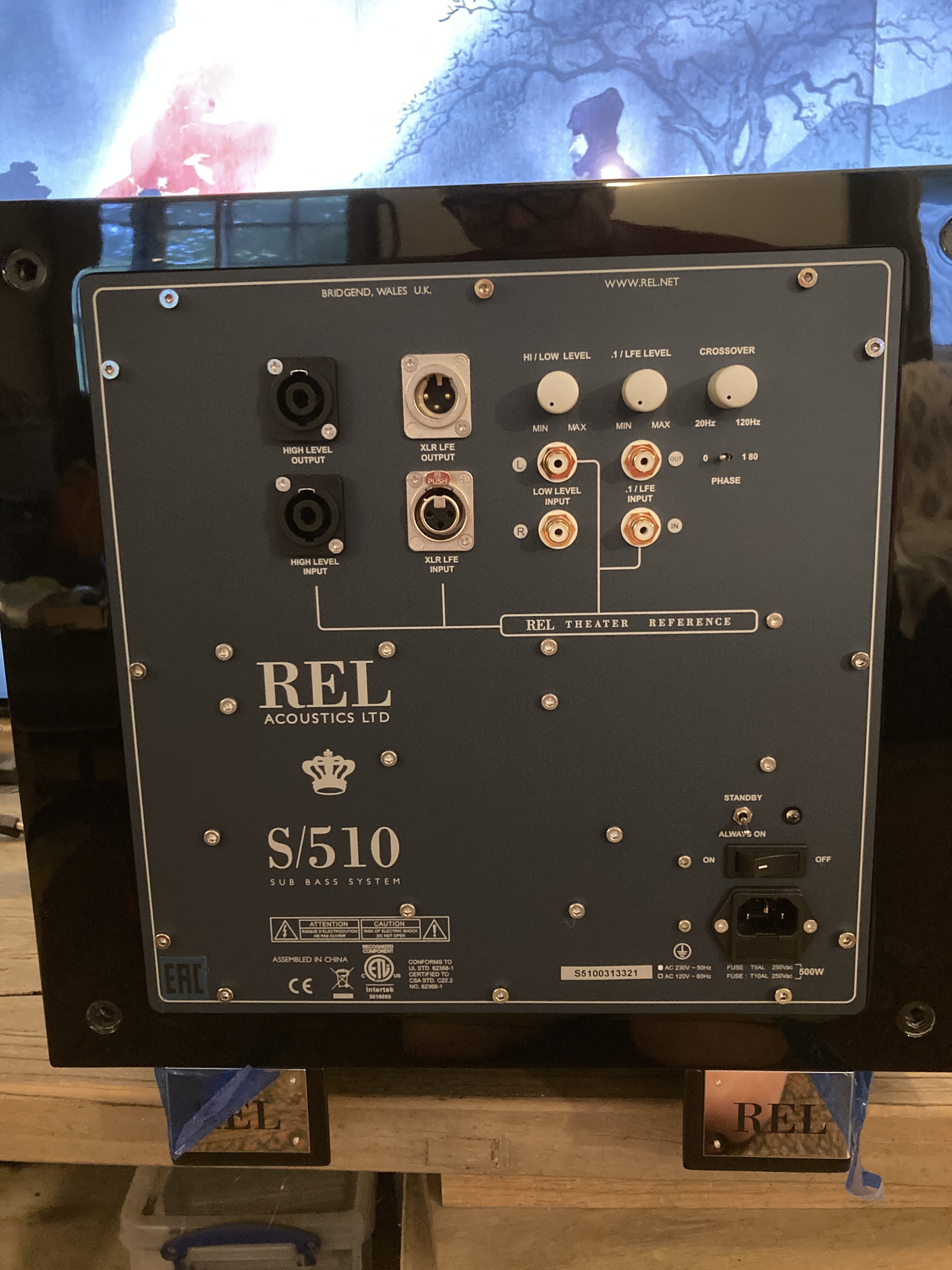

I was called last week by one of the dealers recommended by REL. A demo version of their S510 is available for demo. I picked it up today, but without the necessary cables. The dealer phoned Chord and the necessary lead is on its way. I should have it Thursday.
First impressions:
  1. It’s heavier than I expected. A two person job to place it in the truck, but a single person effort to move it into the house.
  2. Out of its box it’s obvious that there is only one location for it: left hand corner next to the left hand speaker. It’s not ideal but space is limited.
  3. It’s a handsome piece of kit, well engineered although the terminals don’t match the manual. This means I’m questioning the suggested connection (SNAXO’s supercap to low level RCA. But which DIN socket - will it be obvious?)
  4. This audition may be pointless. Time will tell.

I would avoid taking the sub signal from the Supercap powering the SNAXO. Take it from the Supercap powering the 52. Make sure the lead is slugged to avoid the Pre out going unstable.

Always go with a high level connection if possible, although tricky if you’re running active which you are.
I’d speak to REL directly and go with whatever they suggest.
A well setup sub is something that a lot of people (myself included) can’t live without once they’ve heard what it does. I think most people struggle to get the optimal placement and don’t necessarily connect it up in the best way possible, and so have bad experiences. It’s a shame because when they’re done right, it really adds so much to the listening experience. It’s not an easy thing to do and much faff is required (normally) to get it right. There’s plenty of ‘how to’ type videos out there to aid in achieving great results, including some on RELs website.
Remember, you shouldn’t be able to identify where the sub is, it should just integrate seamlessly with your speakers and make them sound like they’re doing it all. If it doesn’t and you can hear where the sub is located or it’s not a smooth transition through the frequency range, then it’s probably not right. Good luck and preserve, it’s worth it!
I wouldn’t bother with a low level connection for music. The high level Neutrik connection works so much better, and really is the suggested approach for a music system. If your REL dealer is worth their salt I’m surprised they didn’t recommend that. Take it from someone who has used REL subs for the last 10+ yrs with Naim, and now has two S/510 in a stereo pair (and maybe four next year).
In the beginning I tried a low level connection from a HiCap on a 282 and I just couldn’t get it dialed in. No matter what I did it sounded boomy and bloated. Using the high level connection was a complete game changer.
Edit: didn’t realize you are running active, so I’m not sure how that would work. REL support is really good and they might be able to advise for the proper high-level connection.

The hi-level connection is problematic at the moment as Neutrik cable as bare wire for binding to speaker posts. Ben at REL has been very helpful and suggested the Naim cable solution. Richard has also suggested that the best Supercap source would be the 52’s rather than the SNAXO’s.

I realise that an active system makes things a little more complicated, as Rel generally recommend that you feed their subs with a full range signal, but is there any reason why you couldn’t take a high level signal from the LF terminals on your speakers or power amp?
Yes, 4 pin DIN pre-out
Thats a very good question which gets to main reason why i’m keen to try a sub-bass system. Originally, I had 4x135 driving SBLs. When I swapped out my CDS for a NDS I was also persuaded to swap the SBLs for Ovator 600s, but still with 4x135s.
I don’t have enough room in my stacks for an additional 2x135s (or a 250) so my then dealer rigged up a little box so that the 135s drive both the mid range and low frequency units. A possible solution is putting in the REL, although the 135s are capable of driving both units.
