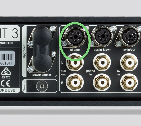

It’s simply a matter of connecting an amplifier to the bi-amp socket - either a 200 or 250 would make sense.

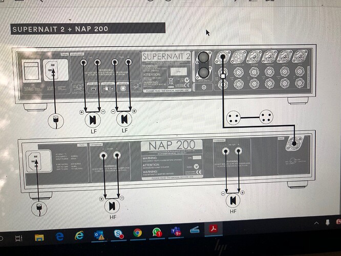

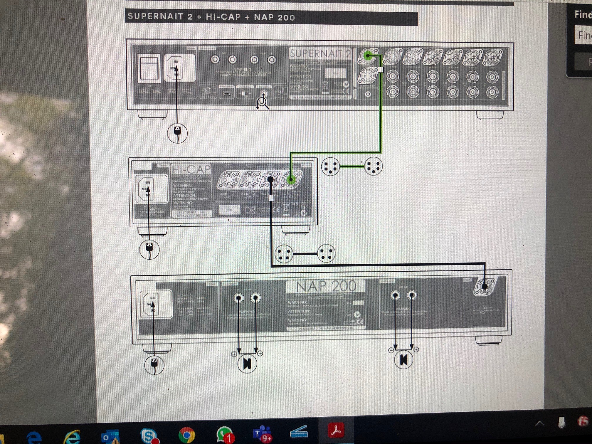

in the connection guide I see a diagram of SN2 plus NAP200 that does the bi-amp. -

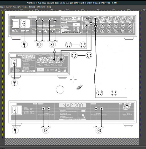

I also see a diagram of SN2 plus HiCap plus NAP200. Here the NAP200 is power amplifier and the SN3 act as pre-amplifier.
My question is how I configure it to be bi-amp and still keep HiCap as an upgrade to the SN3
It’s the first picture with the hicap attached as normal.
I tried biamp with my SN2 and Nap 200
Two pair identical and same length loudspeaker wires needed
Worked a treat for difficult speakers in a large room

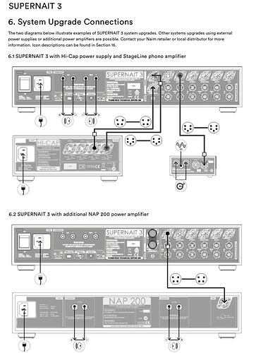

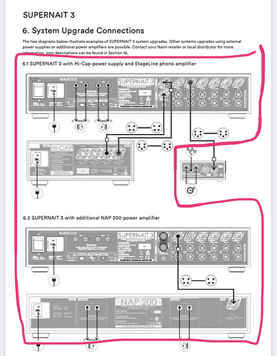

I just have read again the manual of SN3.
It includes the first picture you referred to, But here it it presented as power amplifier and not bi-amp amplifier.

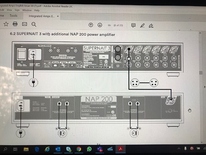

Just connect it to the biamp socket, as shown in the picture I posted yesterday. How can it possibly be hard to understand?
Have a look at the page below from the manual
Connect the Hicap to the SN3 as per the the top diagram.
You connect the additional amplifier either as Nigel shows above (and in the lower diagram) or from socket 2 on the Hicap.
Make these connections.
