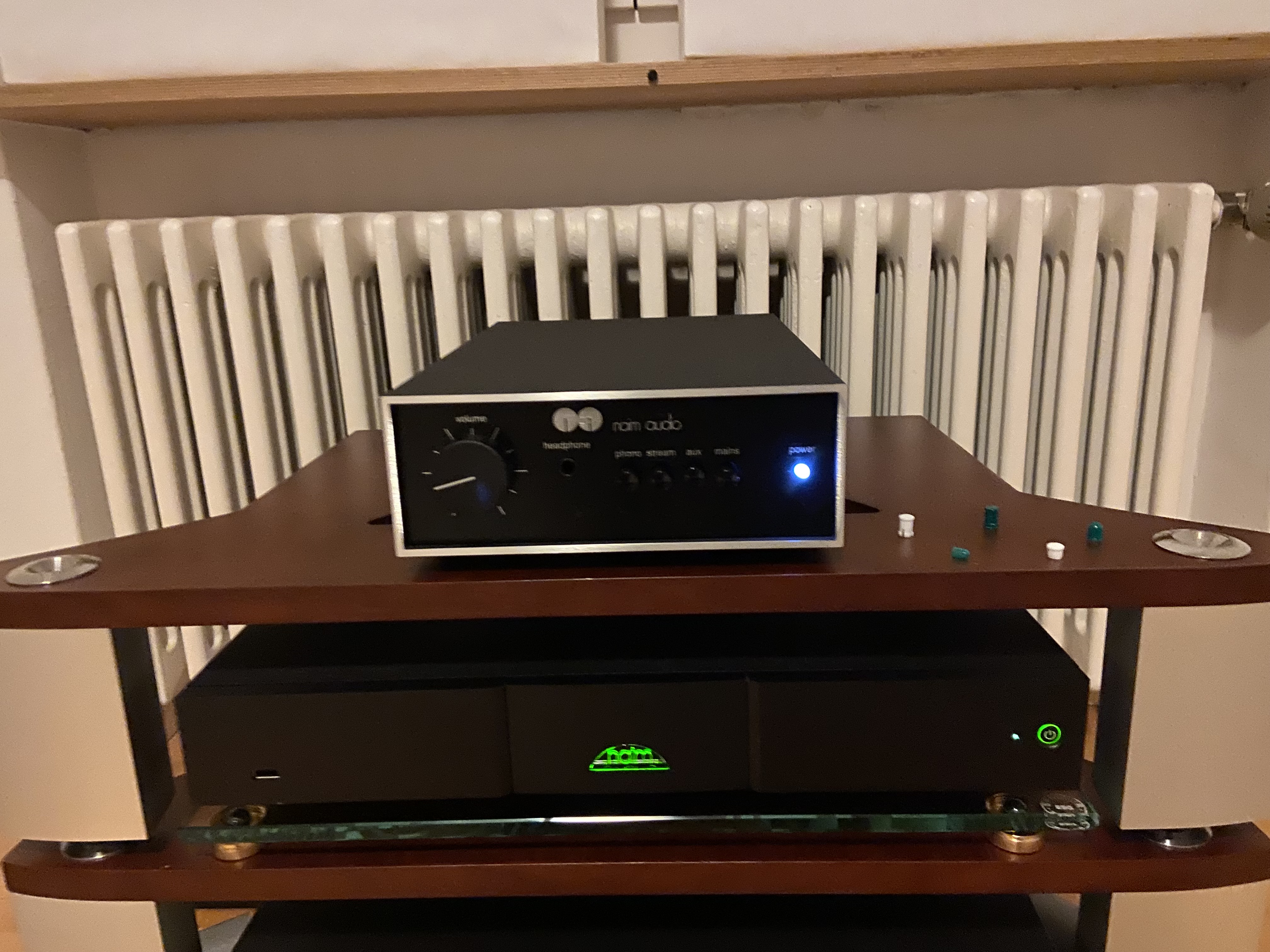

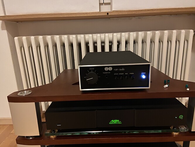

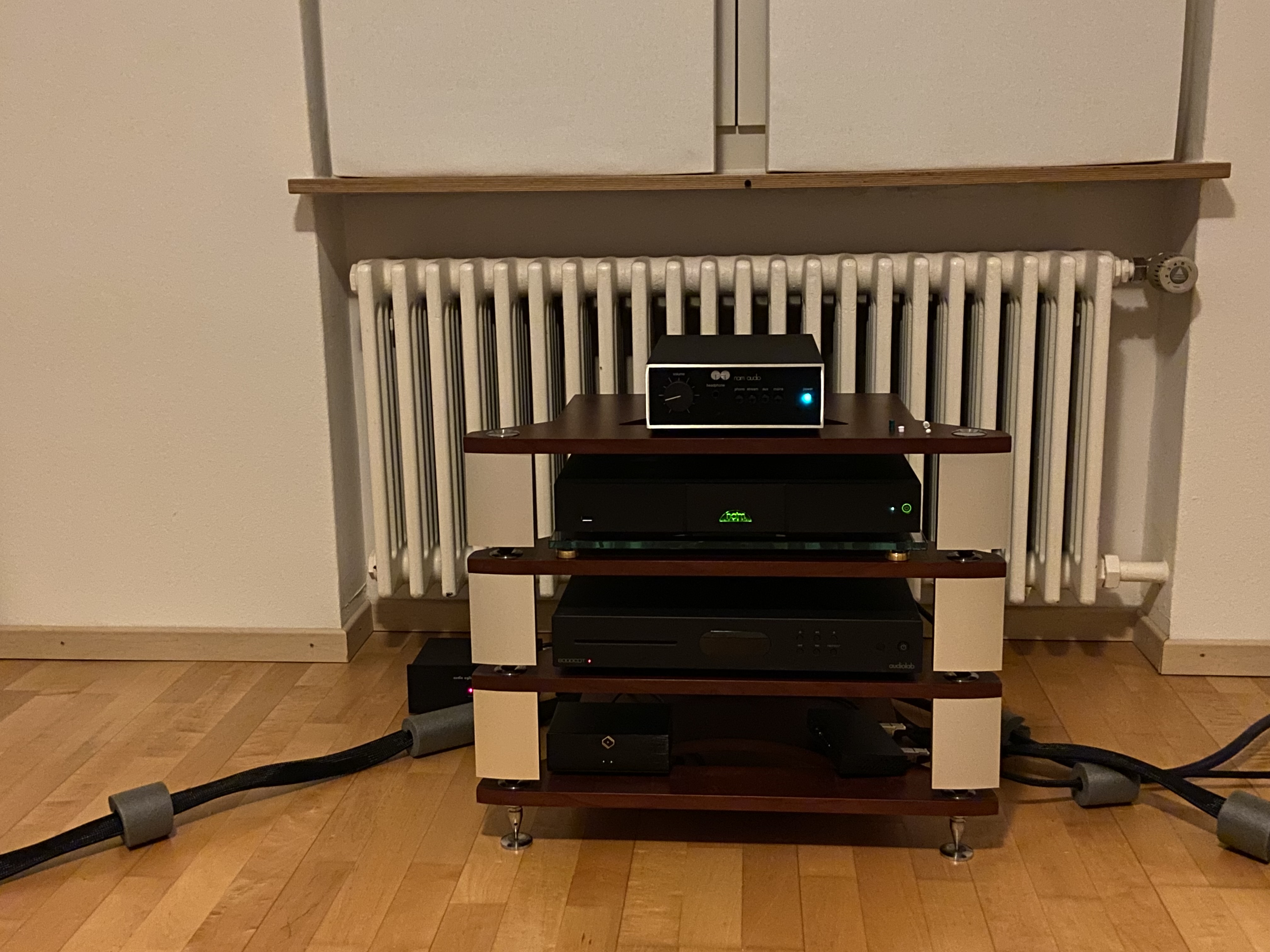

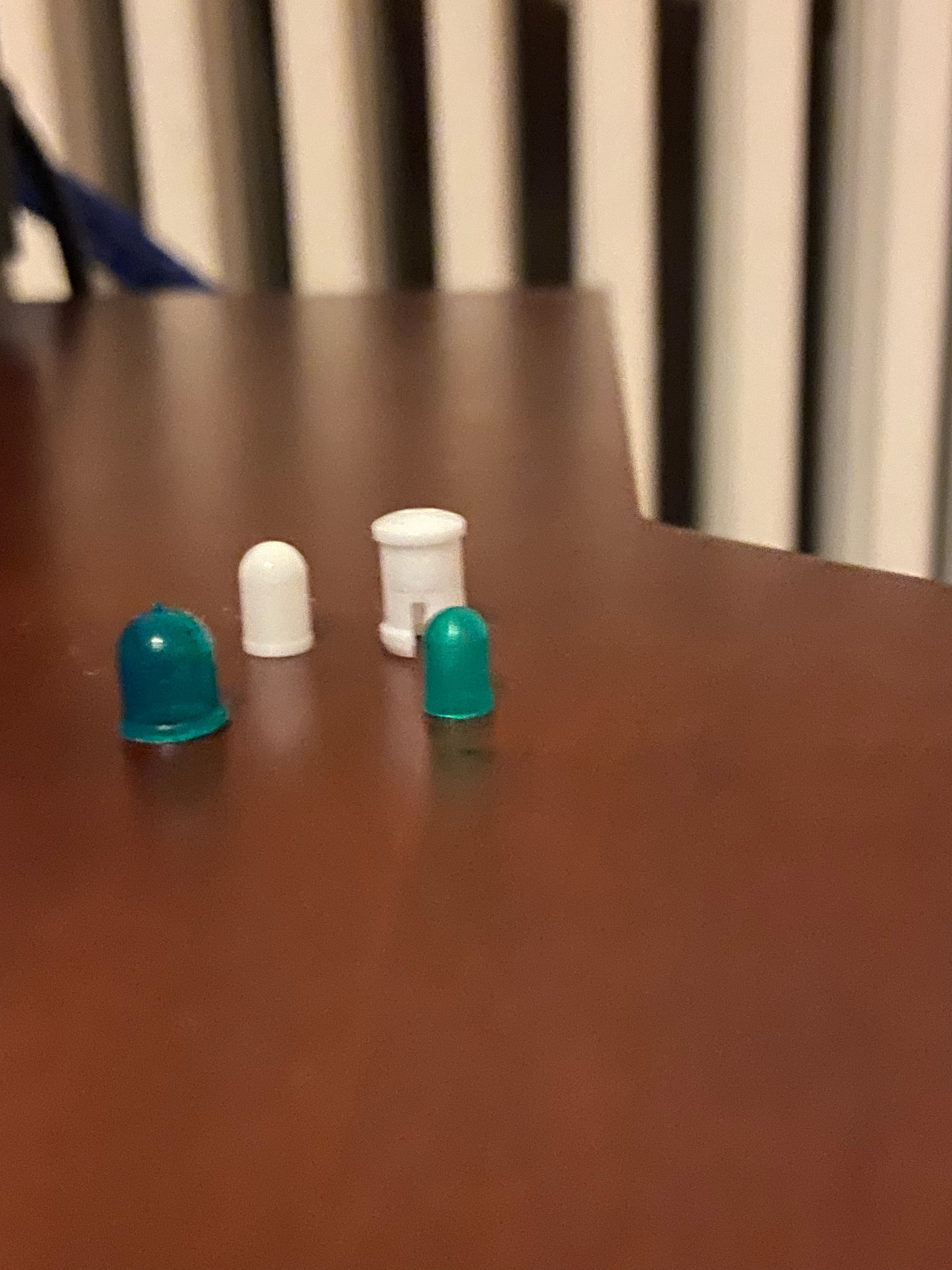

LED once more: because RS costumer service told me that they can only ship in the UK, I ordered various white and green LED lenses from different manufacturers (all 5mm diameter) from Mouser Electronics. They are cheap and were delivered in a few days. However, shipping (from Texas/US to Switzerland) costs 20 euros. I achieved the best result with a combination of 2 green and 2 white lenses.
  • the green variant (light green and green variant) comes quite close to the LED of the ND5XS2. The brightness is reduced by around 50%. However, it is still brighter than the small LED on the streamer. Unfortunately, I didn’t order any yellow variants. This would probably bring the colour variant even closer to the original Naim LED colour
  • the white version (two white lenses) is more subdued and very pleasant.
    Green or white is a matter of taste. The lenses are easy to slide on, even on top of each other. No glue was required.
    I could give the article numbers from Mouser, but I’m afraid that would be against the forum rules.
    (First Photo original, others are variants, in reality the difference is bigger than on the Photos)
