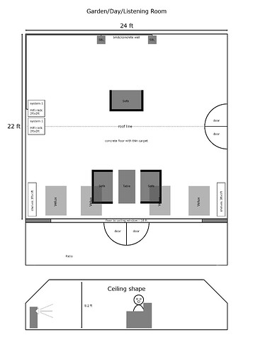

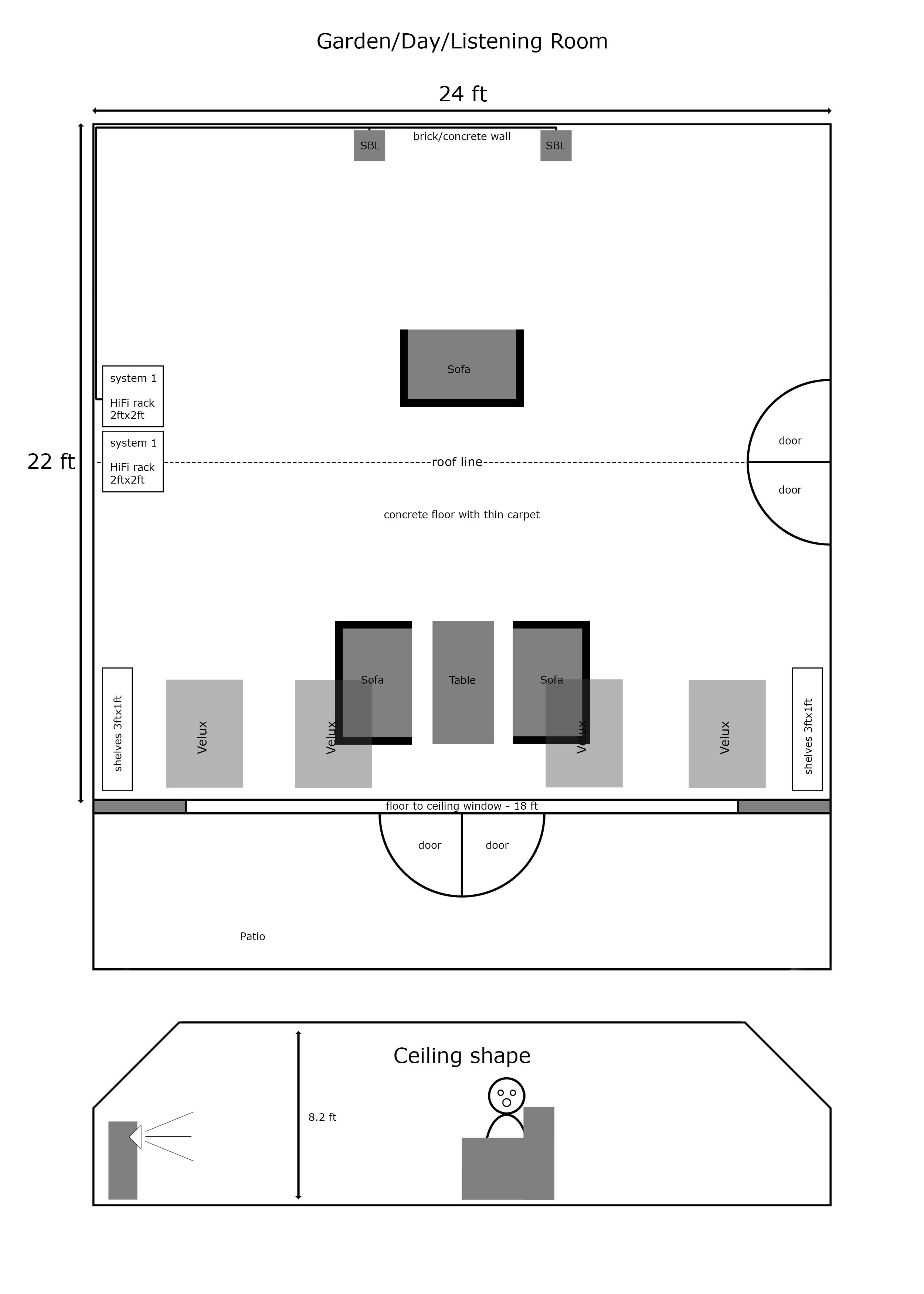

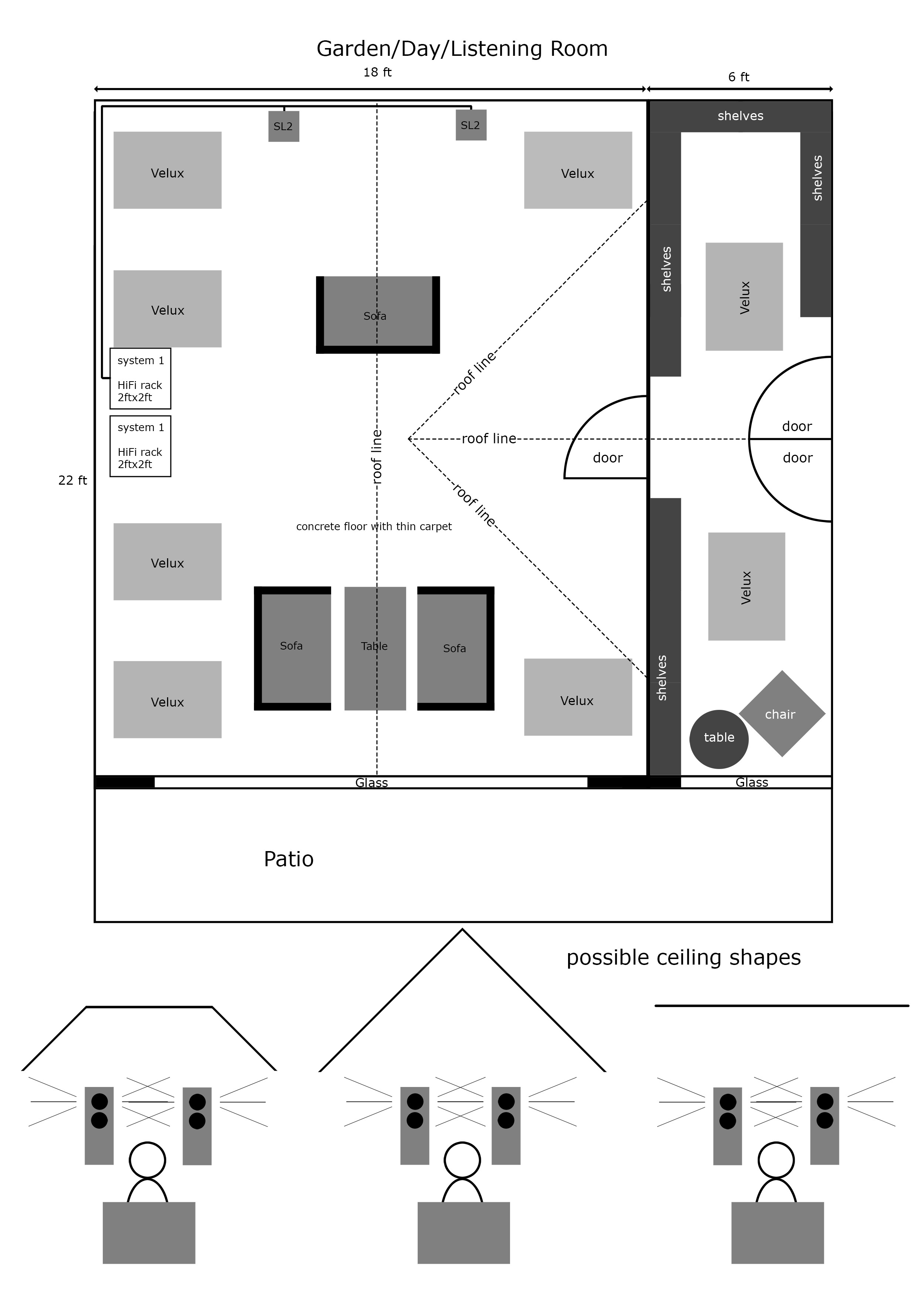

I asked Richard if he’d re open my old thread “The perfect listening room” again as I’ve been tinkering with my design further and came up with a second option.
As you can see I’m not really after the perfect acoustically perfect listening room (although that would be nice) but I’m after the perfect room to listen to music in.
It’s 50% a garden/day room to relax, lounge and chat with friends and 50% a hifi audio listening room.
The first design is just a large open plan room and the second is basically the same overall foot print but split into two separate spaces.
I was just wondering what forums members thought and if they had any further input.
Click on the images for a larger preview or click on the image again (twice) for an even larger preview.
Option 1
Option 2
View outside

Forgive me if I am lagging a bit here in where you have got to. With the SL2s (keepers?) in such an environment, my intuition, and from having heard them playing (active) in a room with an 8ft ceiling, is:
1- better nearfield (say 1.1:1 – ish), which appears to be where you have the listening position sofa? i.e. so that any ‘mush’ gets lost behind here – and hopefully doesn’t come/bounce back.
2- if you want to maintain the room as a living space then, in case of need, you can use free-standing treatment panels, and simply park these away when not required.
As others have said, a square-ish room presents the bigger challenges.
3- An apex-profile ceiling (offering much higher than 8ft/2.4M) would appear to help prevent awkward reflections – I’d check with acoustsic consultants first.
Question – are you wedded to the SL2s, as such a space could accommodate an arguably (!!) better 'speaker, which would be better situated away from a rear wall. Solving the space with the SL2s seems fare easier and, obviously, keeps the 'speakers out of the way from a living perspective.
Thanks. The NAT-01 and NA-PST should be sitting on the top and third shelf on the right, but are (or have been) with Naim for servicing at the moment.
I currently have six pairs of speakers, I just used the SL2’s as an example of where the speakers would be and where the listing position would be.
My current line up of speakers which I’m happy with:
SBL (black ash)
SBL (cherry)
SL2 (cherry)
Neat Ekstra’s
Cube Nenuphar 10 inch
Living Voice OBX RW
I could arguably sell some of my speakers and get a bigger more expensive pair, I could also split the space further into three separate spaces by sectioning off the big/main room on Option 2 into two rooms.
If I split the main room on Option 2 in half I’d have two rooms that were 11ft x 18ft which would give a separate day room and listening room instead of a large open plan day/listening room.
My current listening room is 22.2ft x 22.2ft and I find all my speakers work very well in this space.
