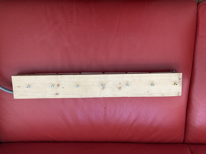

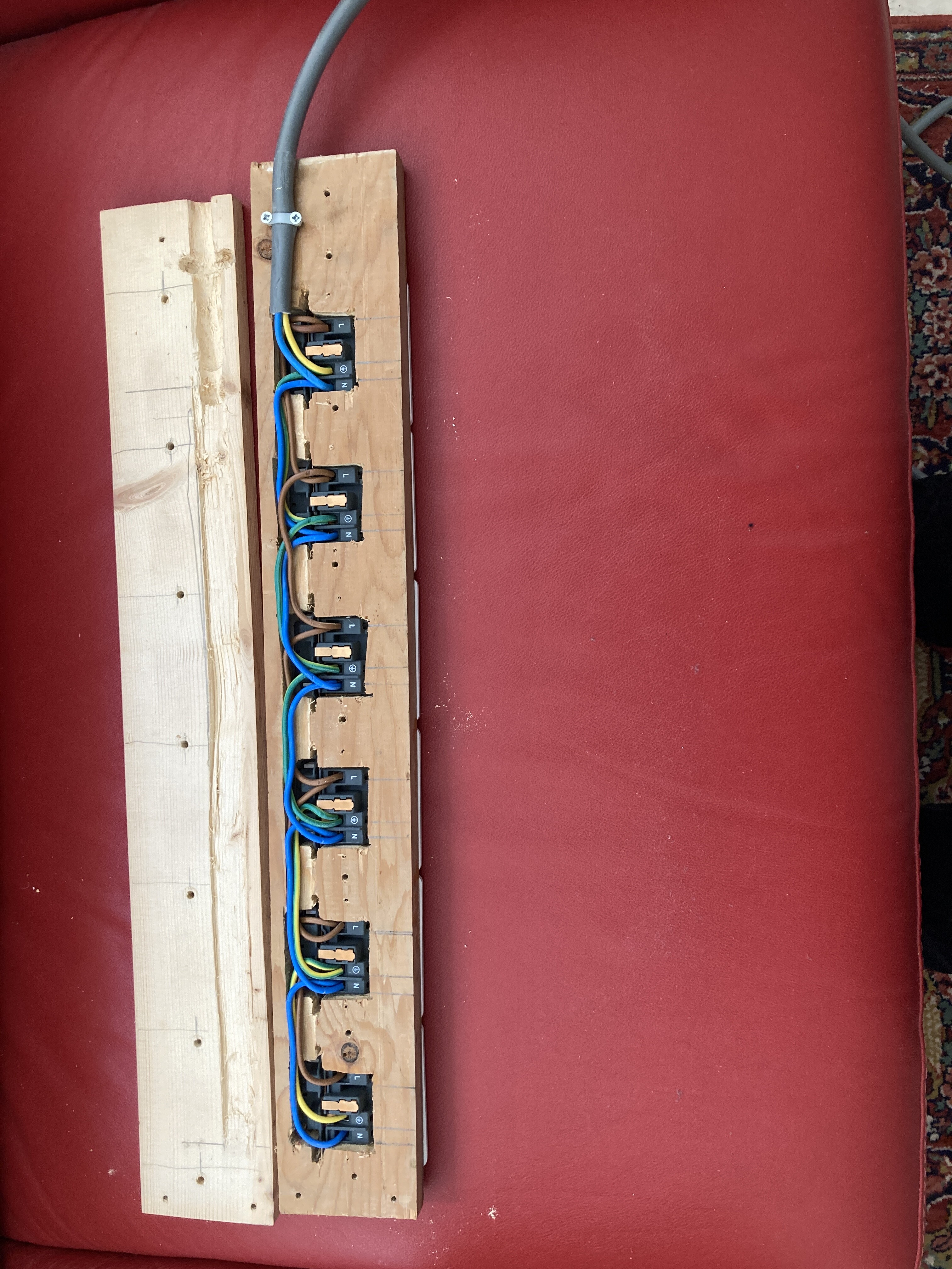

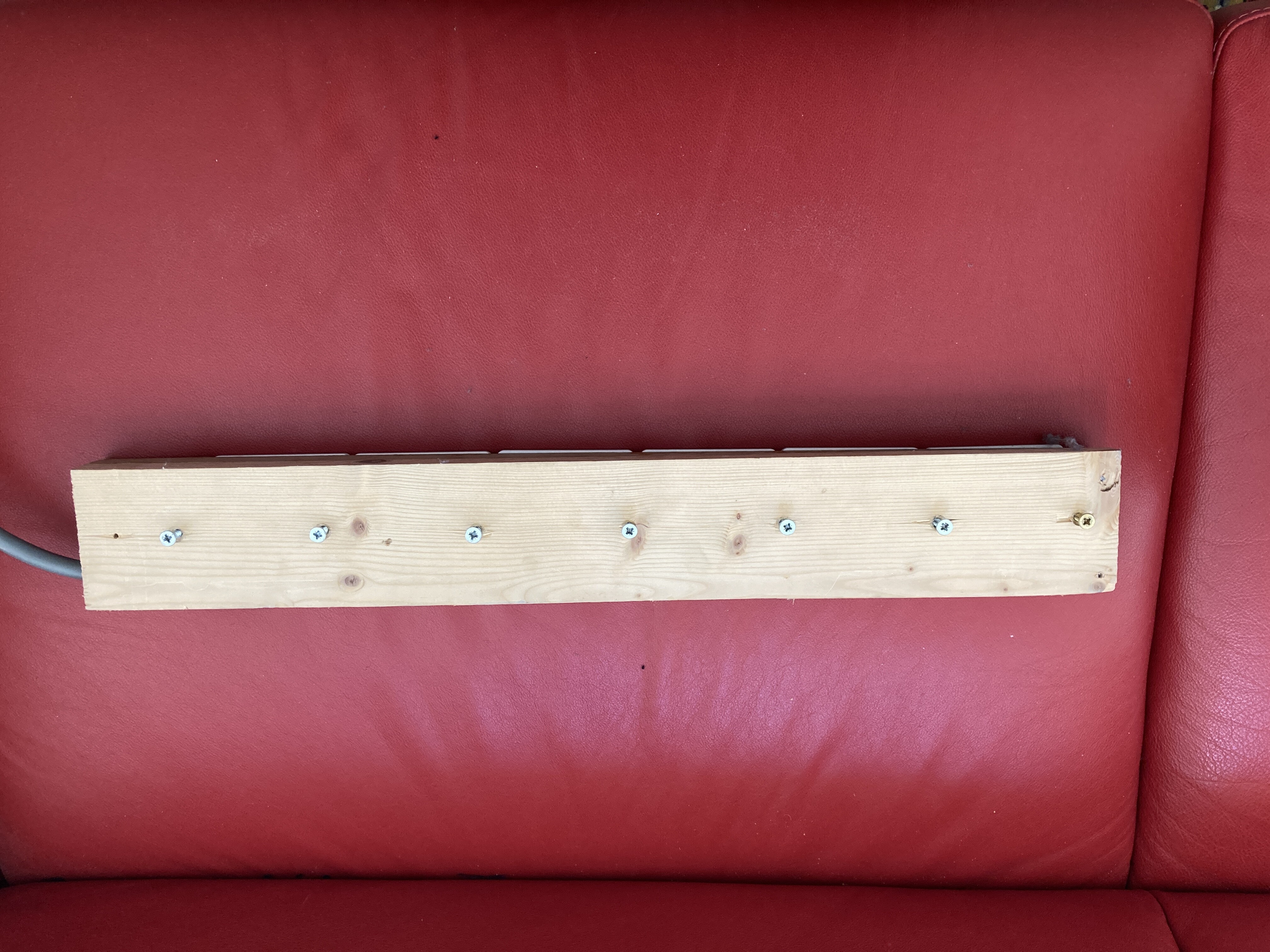

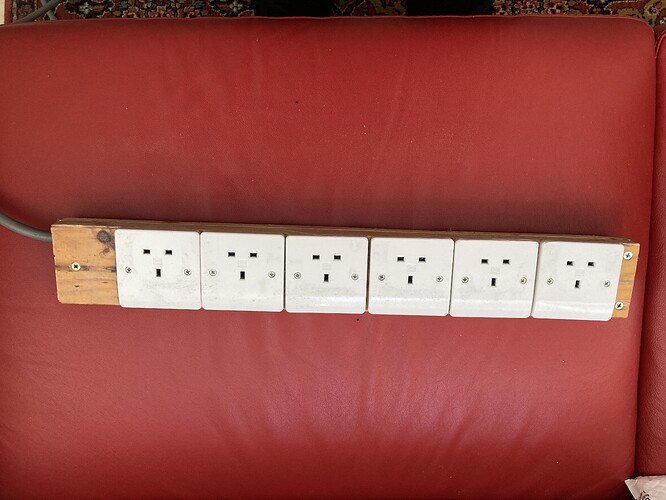

When I moved to France I had a home made power strip using single MK sockets and UK spec powerlines.
I changed the plug on the strip and kept the rest.
No idea how legal my strip is but it works very well, well enough that I could send the Musicworks Ultra back to the dealership without missing it in the least, though extensive trials of plug order were necessary to get the best out of the linear block.
