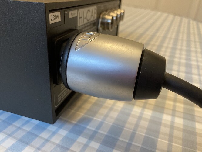

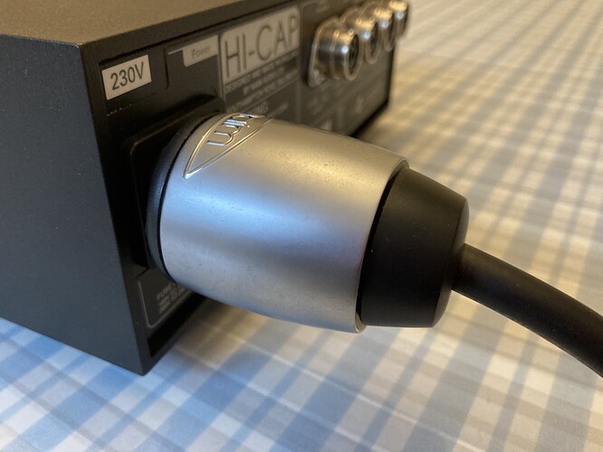

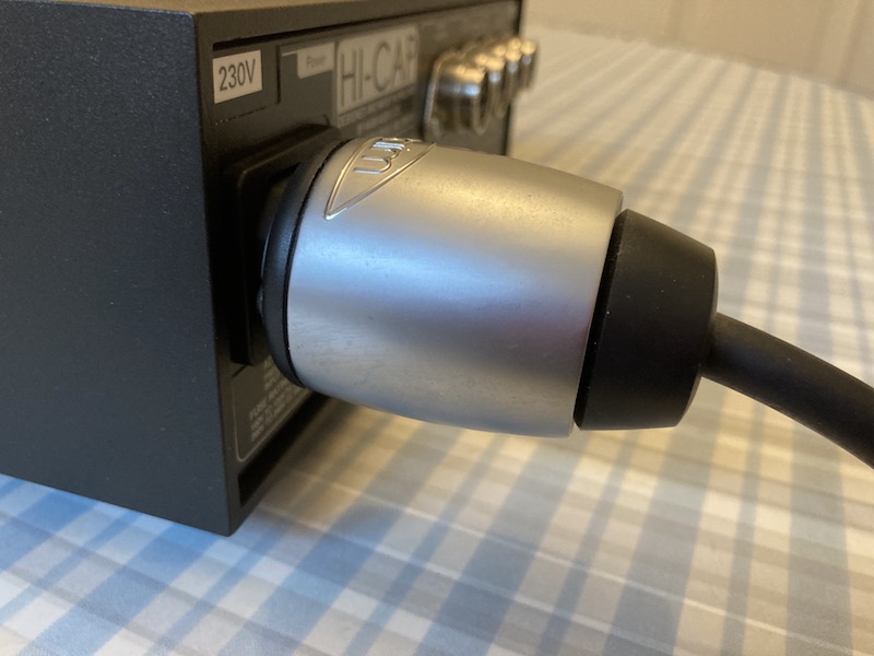

Here are a couple of pictures of a Powerline inserted in the back of a Hicap.
The picture below shows how the rear section of the plug looks when you incorrectly connect by pushing in while also gripping the rear section - note it is still jammed in close to the metal body;
Whereas the picture below shows how the rear section of the plug looks when you correctly connect by just gripping the metal body - note the rear section has moved back a couple of mm and there’s now a clear gap that’s visible;
