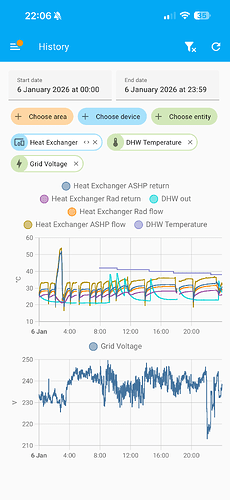

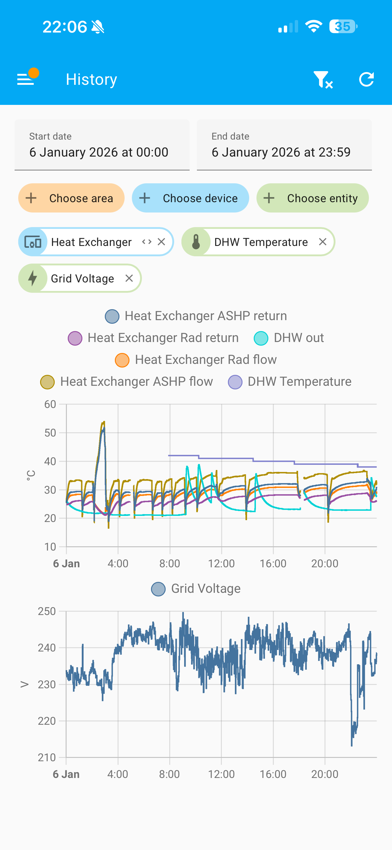

What I find is that increasing the flow temperature below about 2c when defrost cycles start is counterproductive because the interval between defrosting decreases from 50 minutes to 30 minutes at -8c. In this time the the water cannot reach the demanded flow temperature. The extra heat removed from the air causes the heat exchanger in the heat pump to ice up quicker.

The daily electricity peaked at 41kWh on Monday and was 22kWh on Friday. Hourly rates run from 1.5kWh to 1.9kWh for heating.
