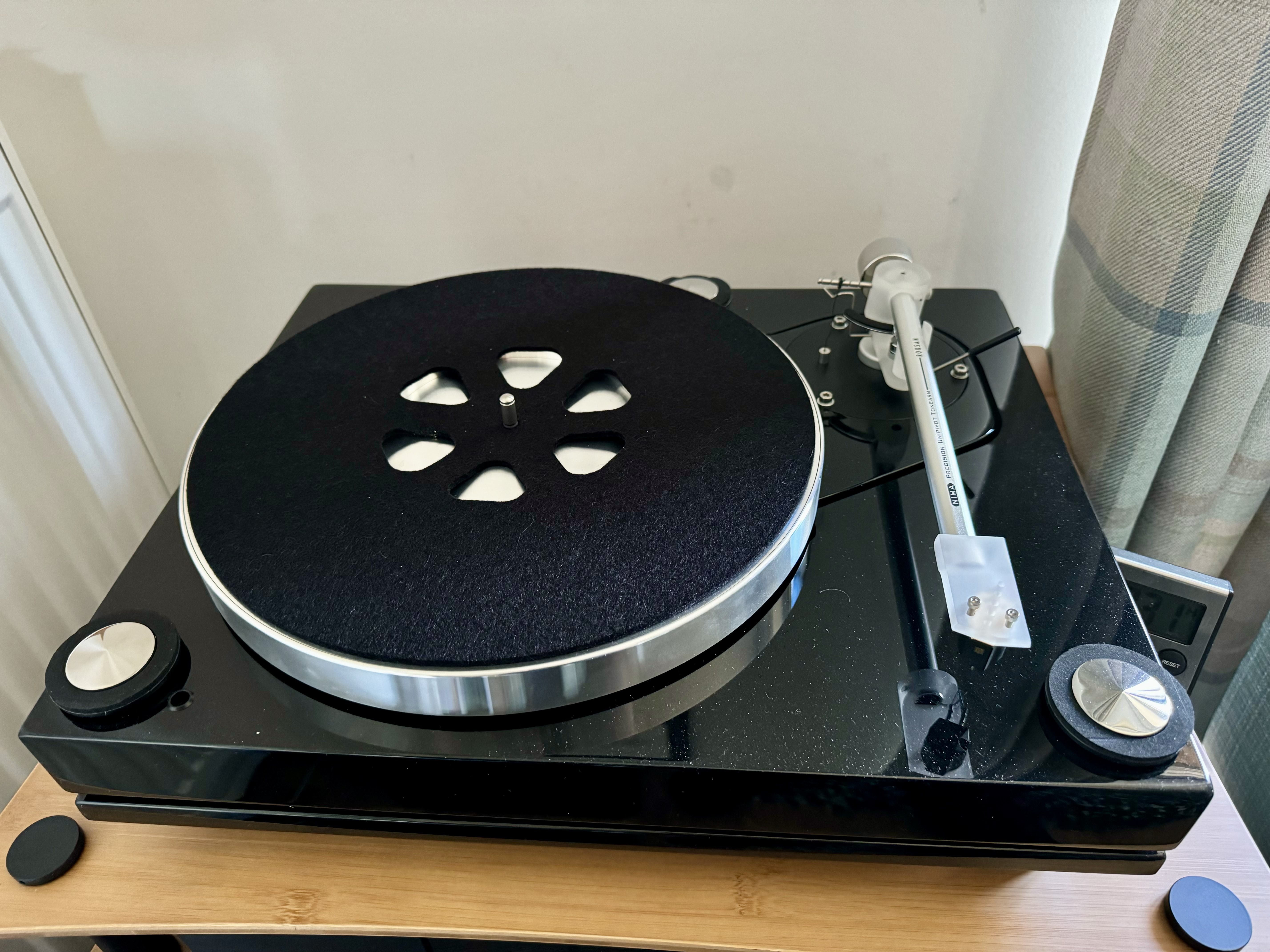

In one of the several large boxes you will get a really nice quadraspire maintenance stand, which is really important in assembling the beast, as you need to work from the top and bottom at the same time. You will need to fit the following the arm and arm cable, the cartridge, the arm comes with a useful protractor to align the cartridge, the inner platter, the belt, the outer platter . All tools are provided such as Allen keys, gloves, spirit levels and so on. As along as you follow the correct instruction manual you shouldn’t go wrong, it is likely to take you 3 to 4 hours to setup, any problems contact Roksan Technical support, the dealer isn’t the greatest at providing the correct answers. When completed it should look like this

Looks great but I’d fit a fingerlift on that arm

It does come with a finger lift, but I forgot to install it. Will get around to it, but to do it I have to remove and then realign the cartridge, so it’s not urgent.

I ran my Roksan Tabriz for 20 odd years without a finger lift, there was a time I’m sure it was suggested as a mild tweak to remove them if the arm allowed.
Looks like a great deck!
I think you are right about it supposedly making things sound better. I have not seen any pictures of a Nima with one fitted, which is probably why I didn’t fit it. Also I have never used a finger lift even if fitted to an arm, don’t really see the point of it. The deck is outstanding VFM, at the moment it can also be had with a Sara Tonearm and a Shiraz cartridge for half of it’s £12500 price tag. The Shiraz is £3465 on its own!!
