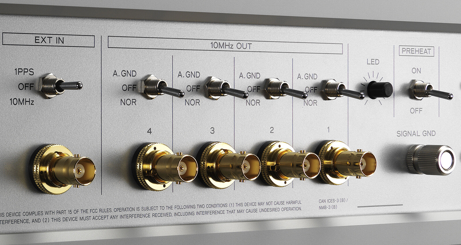

Well in the case of the Esoteric, it’s a master clack generator, not a variable word clock. All outputs are fixed 100 Mhz
It sounds more like a 10 MHz frequency reference rather than a clock generator. I suspect you can then add another box which generates the word clock at the appropriate frequency. Not cheap and whether it’s strictly necessary…
For Esoteric, no. Just the 10 Mhz master clock. I’m not aware of any support for word clocks on any of their transports. They all take a 10 Mhz in.
They are certified atomic clocks though. They have an internal enclosure for the isotope and sensor. It’s both nonsense and very cool all at the same time.

Are they not referring at the external clock input on the Grandioso external clock from esoteric? There it is possible to add an militaire GPS based clock with an 10mhz output.
blimey such expensive clocks - the price of rolex?
Nope. The Japanese site shows the isotope enclosure and specifies the isitope and particle rate it emits. Rubidium is used as in many atomic clocks.
Maybe you can explaine this:
A 10 MHz or 1 pps reference signal can also be input externally by connecting a device such as a GPS receiver to an external input terminal. The internal rubidium oscillator is synchronized with a higher center frequency precision clock received from a satellite, and this allows more stable rubidium oscillation than the crystal controlled oscillator built into the external GPS receiver, which makes the most of the advantages of a high precision GPS system.
Err if you want to untangle that, I’d suggest firing off an email to TEAC support.
There is even an review on the internet from some reviewer that connected his gps clock to the esoteric.
