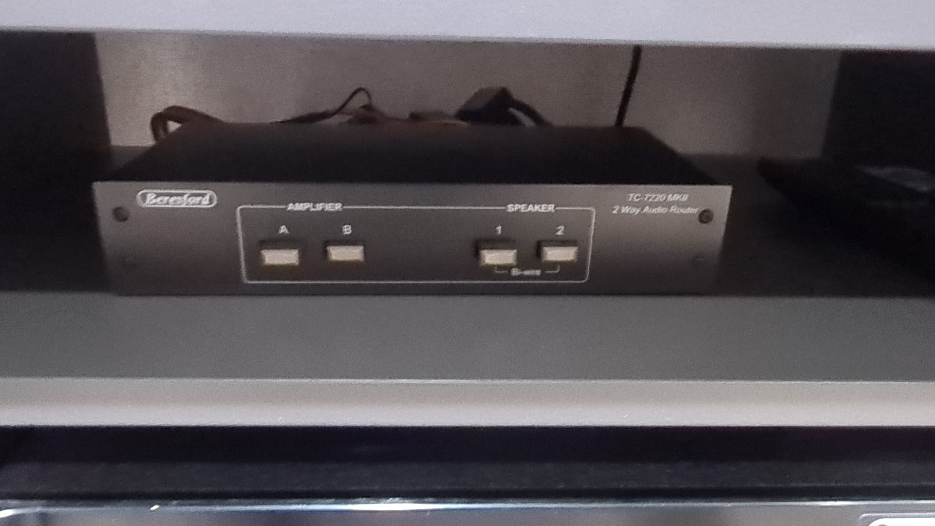

Dan can you please explain how the cabling works on the switch to move the sub between the stereo and the AV systems. I’m intrigued. I have a Martín Logan subwoofer but only currently use it in the Home Cinema system. Your system is looking good :+1:
Hi Andy,
It’s a Beresford switch TC 7220 MkII. Not the latest model. There is a Mk111.
So we have terminals for speaker cables for two amplifiers and two sets of speakers.
There are four switches on the fascia of the unit. Amplifier A and B. Speaker 1 and 2.
I have the following set up:
Speaker cables from Anthem MRX1120 Receiver to Amp A terminals.
Speaker cables from Naim Nap 500DR head unit to Amp B terminals.
Speaker cables from Speaker 1 to Focal Sopra 2.
Speaker cables from Speaker 2 to Focal Aria 936s (conservatory).
Sub woofer goes from binding post on Beresford speaker 2. High level connection, right speaker red wire, left speaker yellow wire, black wire for ground floating taped. This can be connected to negative binding post but I get no hum so have left it floating.
The other end of sub woofer cable has neutrik speakon connector.
Effectively the sub woofer is connected diredt to the speakers. But this means I don’t have to cut the original cable and adapt it. I can feed it direct into the switch.
The other option is to connect your sub woofer high level direct to your speakers. This is what I have done, but earlier on in the chain.
I am using the sub with my Av system and Naim system so easily at the push of a button. If I go for 2nd sub I will just connect direct to each speaker.
TBF I would never have looked into doing this if my sub woofer hadn’t died. I’m glad it did as I now have a completely different system to listen to! It’s early days yet and I need to get my head round it and over the initial burst of enthusiasm.
These things take time. However, initial impressions are very very good. It’s a case of getting it to work seamlessly and in an integrated way. So yeah, on drum and bass tracks a big bass sounds great but less so on The Nightfly! It’s a case of balancing things out and making use of the deep base. There’s no point turning the volume up one or two notches. You may as well not have it. I am experimenting with it around half way mark. The crossover is set lower than half way mark at the moment. Tuning it in is trial and error.
PS the maximum loading for amps is 200 watts per channel for Beresford. I would think this won’t be an issue unless you are driving your amp to max Andy. Never been a problem with 500DR or Anthem MRX1120. Both are 140 watts per channel into 8Ohm.
I believe your amp maybe 250 watts per channel. It’s just a switch. No power cable. It’s very useful.
Thank you for that comprehensive description Dan; I will look into this further. :+1:
It’s a case of whether or not your sub has a high level connection that can link to your speakers, rather than your amps. It’s worth looking into.
