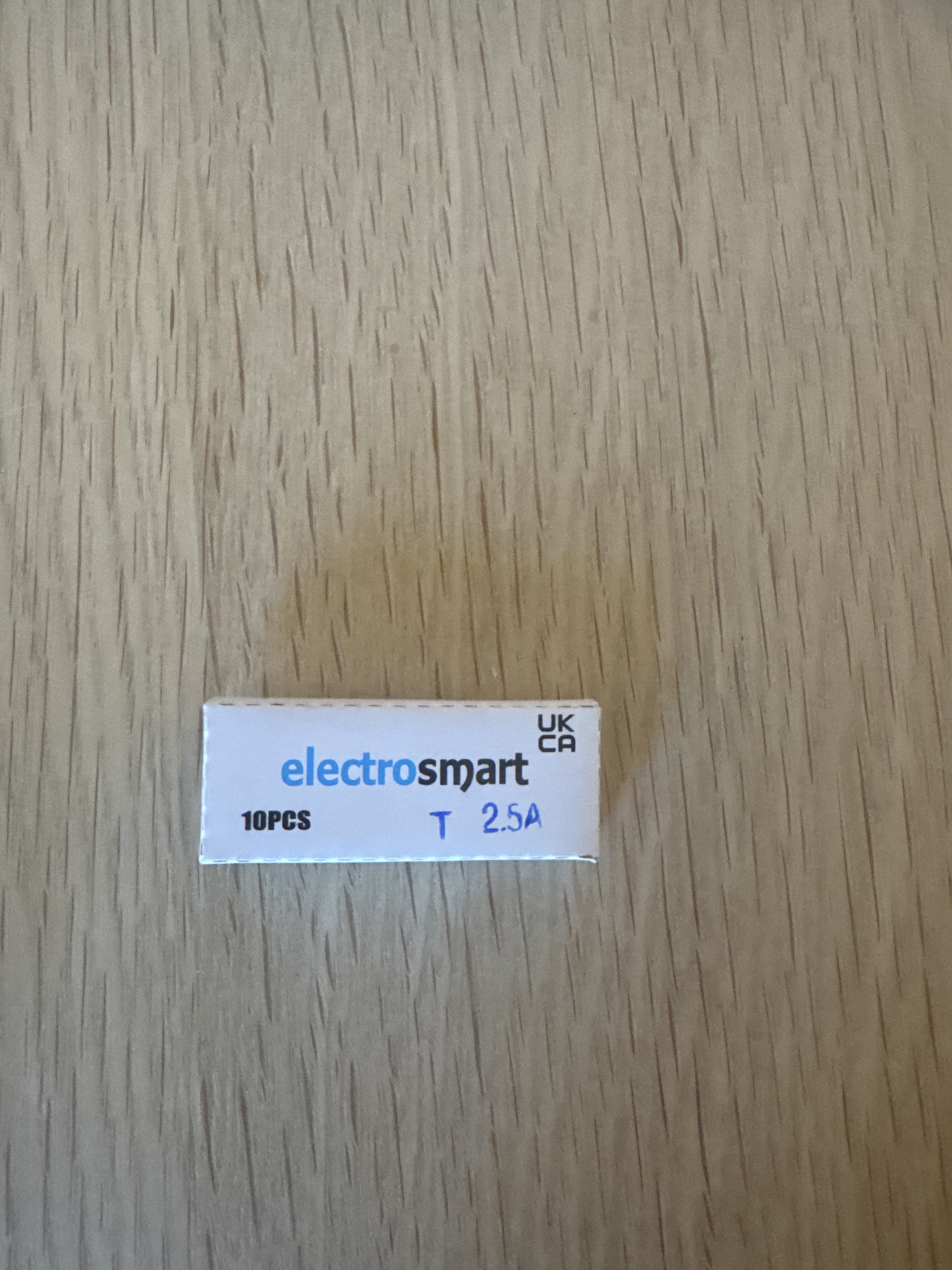

XPS DR glass fuse
Is this a suitable replacement?
See here.
Amazing how XPS power supplies eat their protection.
I think its the inrush current on switch on
Maertin
It’s important that you replace the XPS2/DR fuse with an exact like for like replacement. The Littelfuse is the best one here and least likely to blow at start up (although still a possibility on some units). It’s unfortunate that it’s right on the tolerance edge for the 2.5A T fuse, however the next value up is not adequate to fully protect the unit so cannot safely be used.
They are the right rating but I had the same make and unfortunately they are prone to blow after a short time, if you do not turn off your XPS you may get away with them for a short while, best get the recommended fuse and save the heartache of keep clearing the fuse holder of glass, Richard stated the best make option.

It’s easy to order the correct make and rating from a reputable dealer online. I’d order a few of them as back up just to be on the safe side.
Those fuses with the coloured bands in that thread are the original factory ones that are fitted in a new XPS DR. So are correct. The clear glass ones are replacement spares from dealerships.
