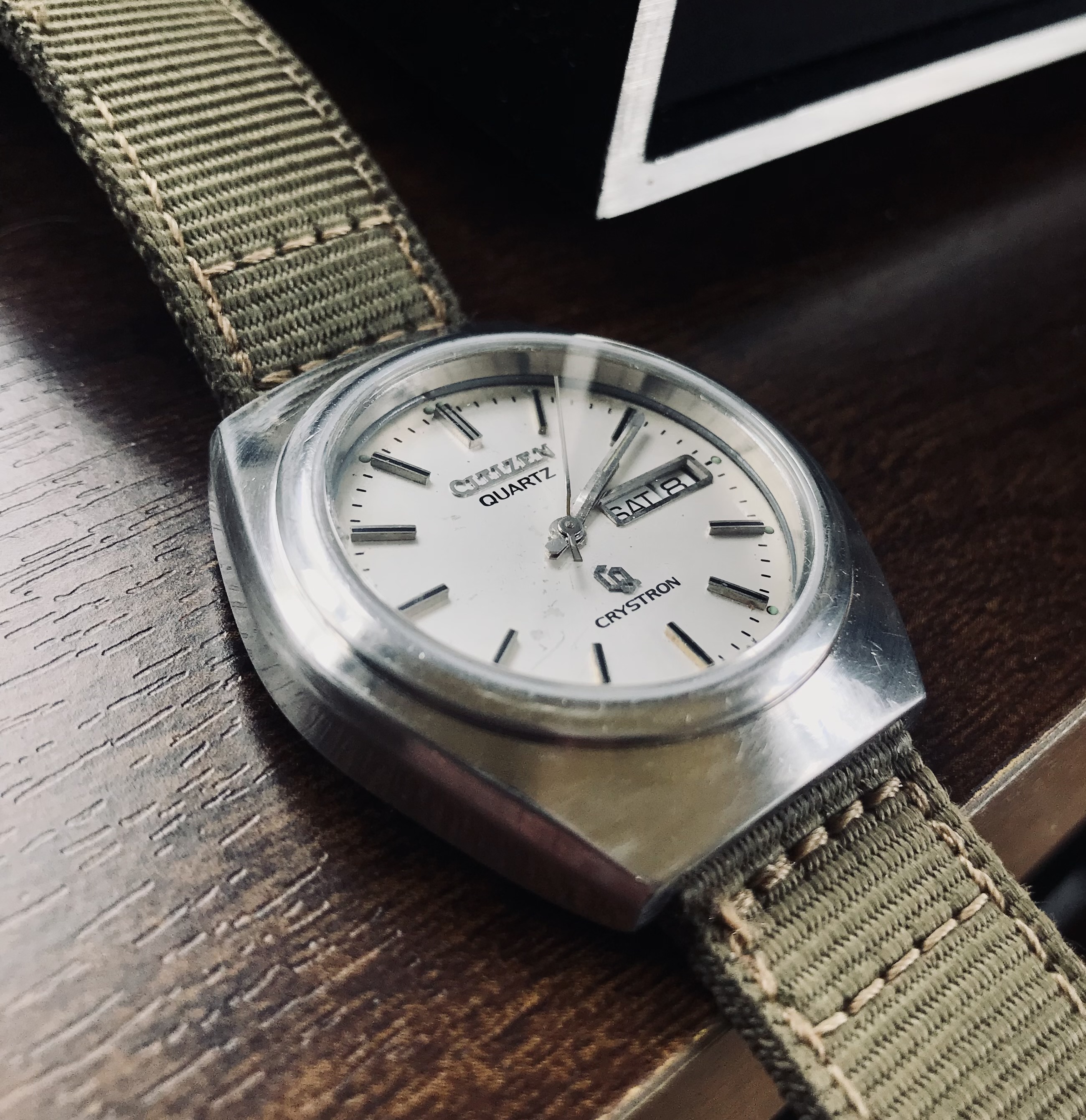

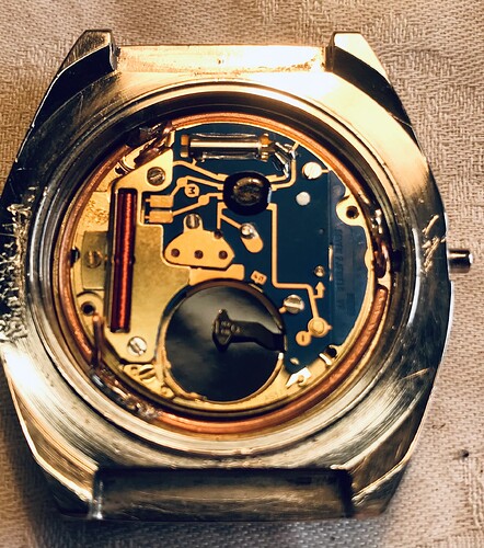

Ancient Citizen I’ve had since a teenager. Original quartz movement dead and gone - replaced with an ETA by me a couple of years ago. New sapphire crystal and full gasket set at the same time, but not waterproof by any means. Keeps excellent time - maybe runs fast 1 second/ month.

Well done, was it hard to size up, then get it aligned?

Thanks! And yes there were a few problems that needed some ‘work arounds’ -
This particular ETA movement is a little smaller than the original but has the all important day/ date in the exact same place as the original movement, so I figured everything else was doable. I made up a copper ring with some small lugs soldered on that the new movement could be attached by, then epoxy glued the ring to the inside of the face.
Next problem was misalignment of the crown shaft to the movement, which needed another copper ring ‘spacer’ between the face outer surface and inner bezel surface to correct.
Finally the ETA drive shafts are slightly shorter than the original, so the minute and second hands had to be cranked slightly to clear the face markers. Enjoyed the process though!
Phew - hope you’re not sorry you asked now :blush:
