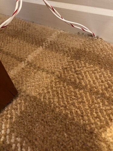

The exact centre of this photo (where the pattern crosses) is where I had a Naim Credo spike inserted for >10 years. You can feel an indent with your hand, but cannot see it when 2+ feet away.
