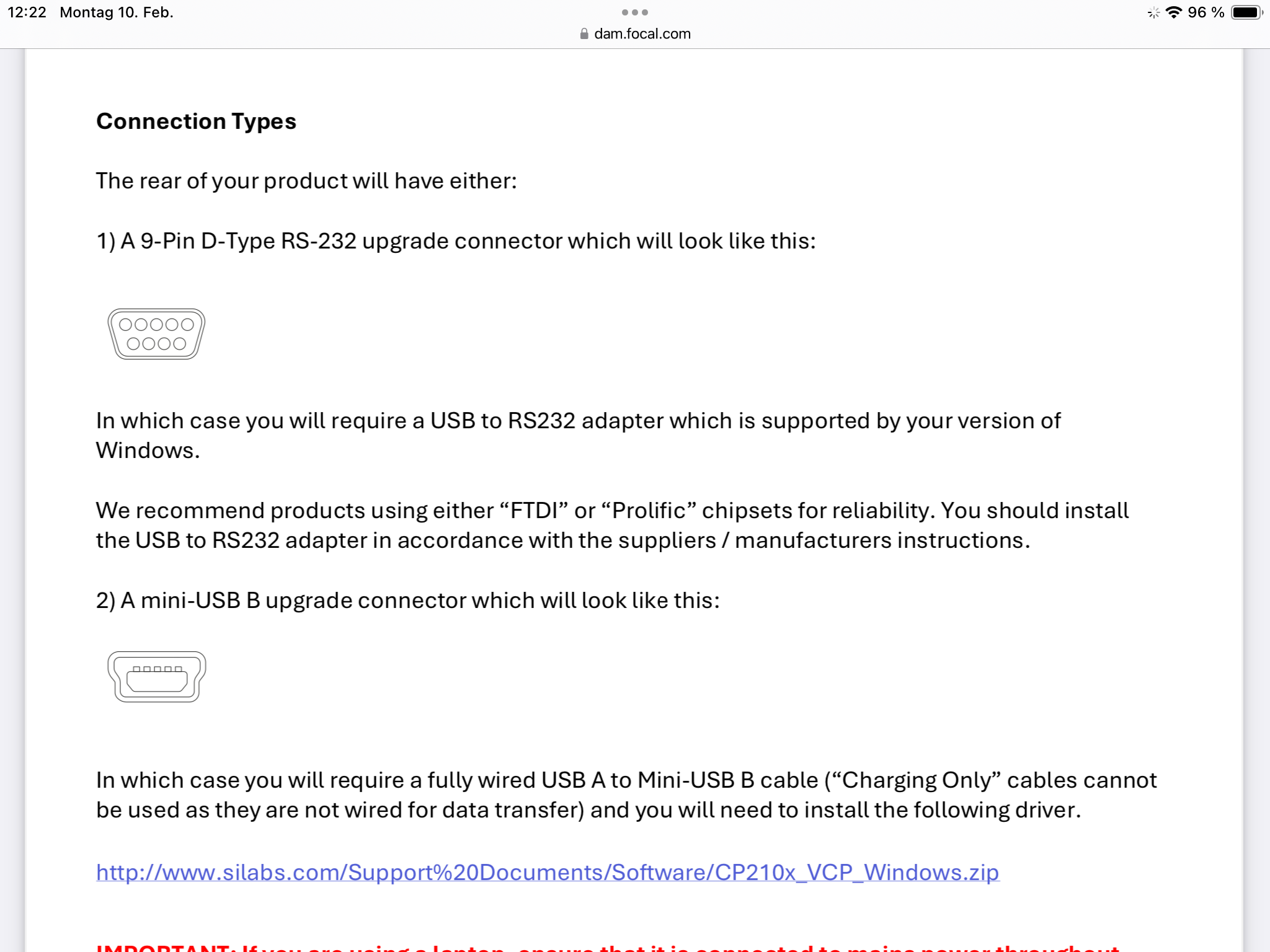

cp2102bridge to usb driver not available. sound when connecting pc to nds but does not appear port selection
anybody had same issue? pc with windows 11, NDS connected with USB B cable and hard cable to the network
Look in the How To on side 3. There is a link.

https://www.silabs.com/documents/public/software/CP210x_VCP_Windows.zip
