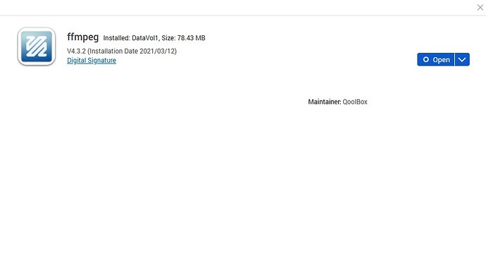

I’m getting a bit confused here. I installed the binary from QNAP Club and it doesn’t seem to do anything. I can see it installed in App Centre and this is what I see but if I click on Open it doesn’t do anything. Should it? Transcoding options in bubbleupnp server remain greyed out even after restarting the server. If not that package what should I try installing?

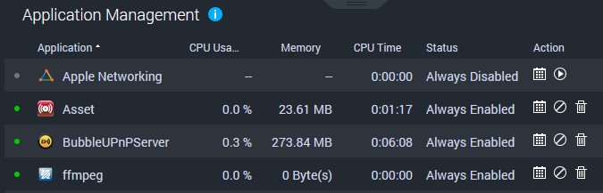

Also this looks a bit odd, zero bytes memory used?

TS-NASX64_64. But I would go for using container station as there is no issues with ffmpeg as it will be bundled with it. My installed app version from QNAP club works with even QNAP club ffmpeg disabled I just can’t do video transcoding. So I can’t help beyond that. My recommendation is to use container station
