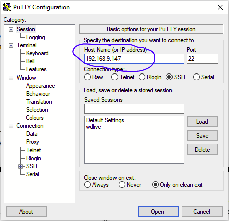

Sorry you need to use PuTTY to login to the raw console. If that’s beyond your knowledge then it’s difficult over messaging to advise, however
First of all you really need a ‘proper’ PC to do this. Goto putty.org on 'tinternet and download putty.
Run the putty.exe programme after downloaded.
Where it says Host Name enter the IP address of your NAS. Click on Open. Note the image below shows MY address for MY NAS. Yours will be different…
On the login screen enter admin for the user and then the password you made for your qnap.
You should then see…
Enter Q to get to the console…
Now you can copy and paste the commands I mentioned before.
Then restart qnap.
for putty…

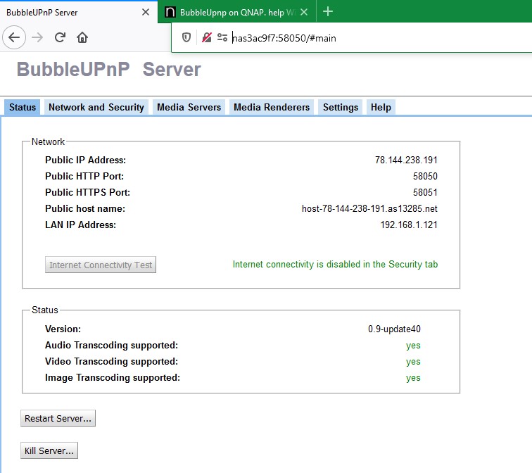

Sorry the pic is too small for me to make anything out but if you have installed Container Station and the docker image inside it as in the instructions in the other thread you won’t see bubble in the main list of apps. Instead just use your browser to look at the setup on your NAS at port 58050 so just put the name or IP of your NAS in the address below
http://yournasname:58050
If you have everything set up properly you should see a screen like this
