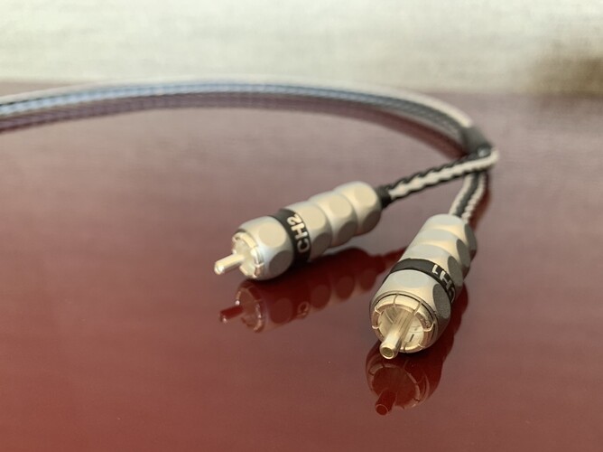

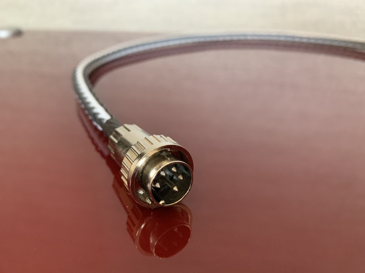

Here is the cable
You shouldn’t be using that socket, as it carries power.
I’m not sure, but I think your DIN connector is 240 degree and you need a 180 degree source cable. That would explain why you cannot fit the DIN in the usual source inputs on your 52.
Yes, 240 degree - khan84 needs an RCA to 180 degree 5 pin DIN cable.
Hi which input should I be using?
You have the wrong din plug. It should be a 180 degree (all the pins on one half of the circle) rather than a 240 degree. It will then fit any of the other inputs.
Thanks guys. I’ve contacted the manufacturer. This was really puzzling me. Glad you Naimees knew your sh**
