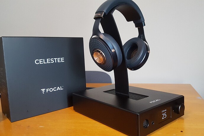

BTW: Do you have experiences with the new Focal Celestee with a Uniti Atom, @Naim.Marketing? Do you think they are working well together or is the Atom not a good system to drive the Celestee? Would it be better to get a separate headphone amp?
Celestee is designed to be easy to drive - even a smartphone or portable player will do; so Atom will be fine. Obviously any premium headphone can reach new heights with a dedicated headphone amp, but the Uniti outputs are strong

Thank you very much, @Naim.Marketing!
It is very challenging in those times to try and to demo products at home or at a dealer. That is the reason why I am asking. Unfortunately my naim partner who sold me the Atom does not have lots of experiences with the focal headphones. So I am reading and watching everything about the Celestee. All seems to be very promising.
It is the first time I am now really considering the “stupid” idea to buy such a product blind (untested and undemoed) :slight_smile:
So maybe I will let you know in a couple of days/weeks how the Celestee is performing with an Atom and my portal devices. :hugs:
