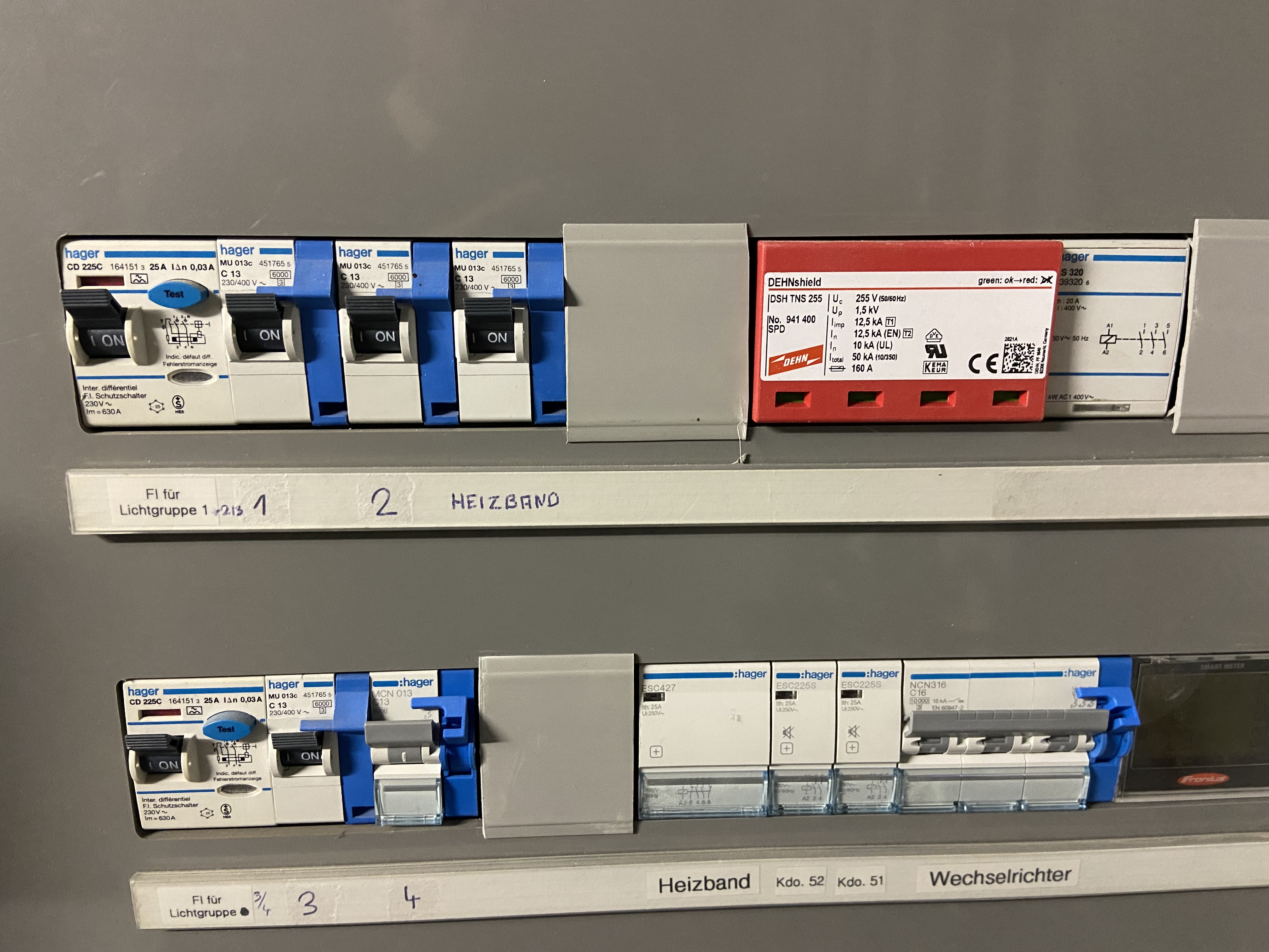

    Should I have the fuses in the basement replaced (currently: Hager Standard see photo Nr. 2) e.g. by Doepke DFS2 Audio and Gigawatt G16a circuit breaker?

The key thing with dedicated mains supplies is to run them from a small separate consumer unit by splitting the meter tails. Isolating the whole thing from the rest of your home electrics as far as possible is the real benefit.
I’d have a dedicated earth rod/plate installed. For the cost (not crazy money) you can entirely isolate the earth from household appliances. But if not possible, ensure that the earth on a dedicated circuit is not shared with other circuits enroute to the CU. It’s common for electricians in many countries to just daisy chain earth from socket to socket crossing circuit boundaries because it’s cheaper and faster and satisfies the minimum safety requirement. But from a noise perspective is awful.

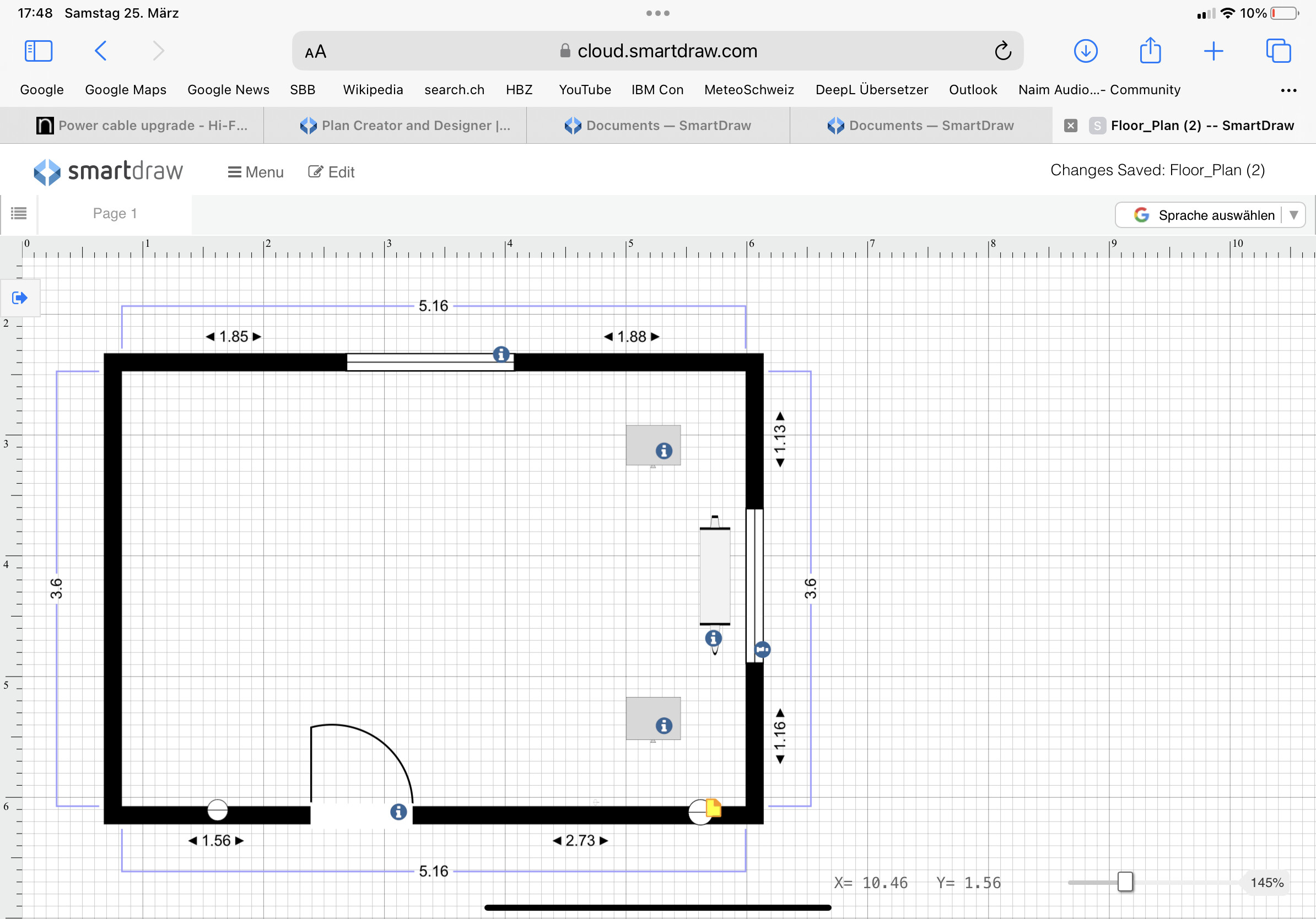

My room measures 5.05 metres X 3.45 metres, so 17.45 square metres - rather small. I plan to place the speakers on a narrow side. Then, with a distance of 2 metres between the speakers, there will “only” be a distance of about 0.5 metres between the speakers and the walls. If I place the speakers on the long side, a near-field situation is created with a distance of 1 metre between the speakers and the rear wall. I have also seen such solutions, but have no experience with them. I have the opportunity to test everything.

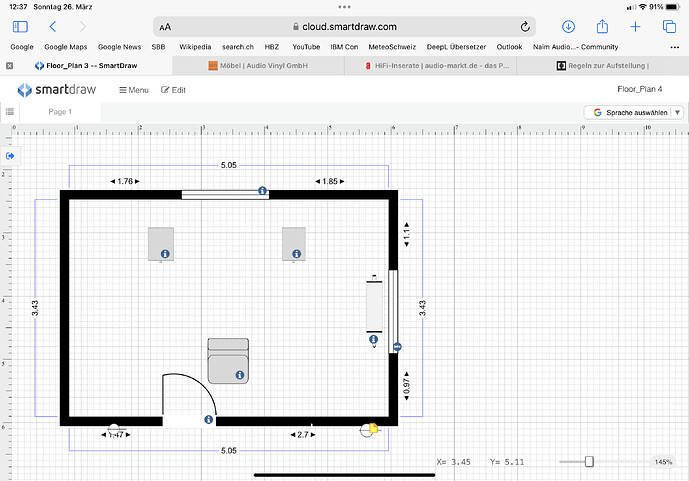

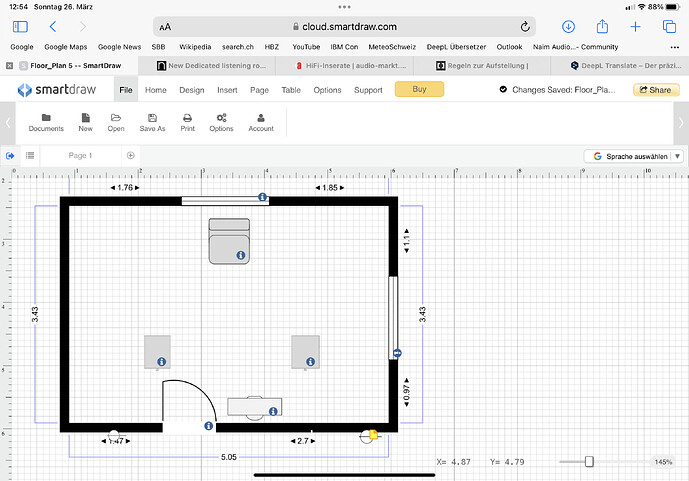

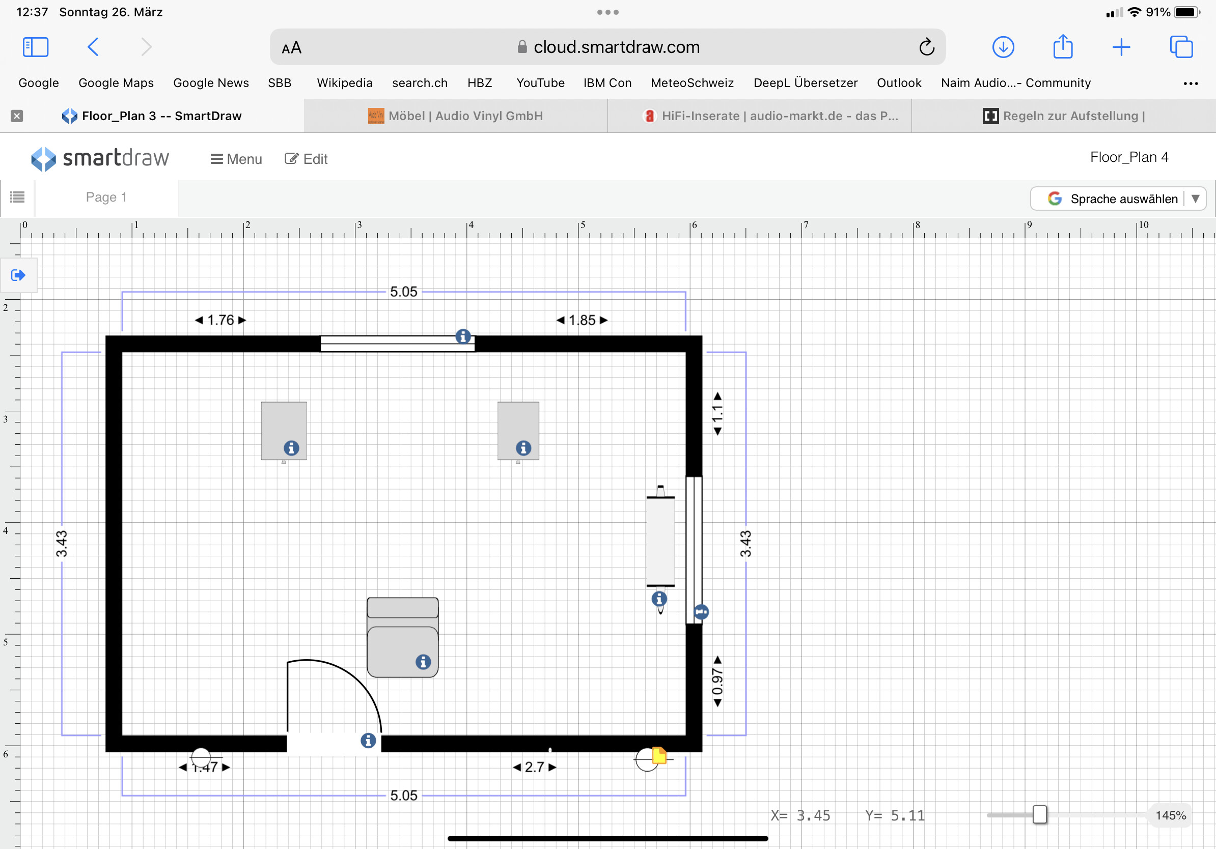

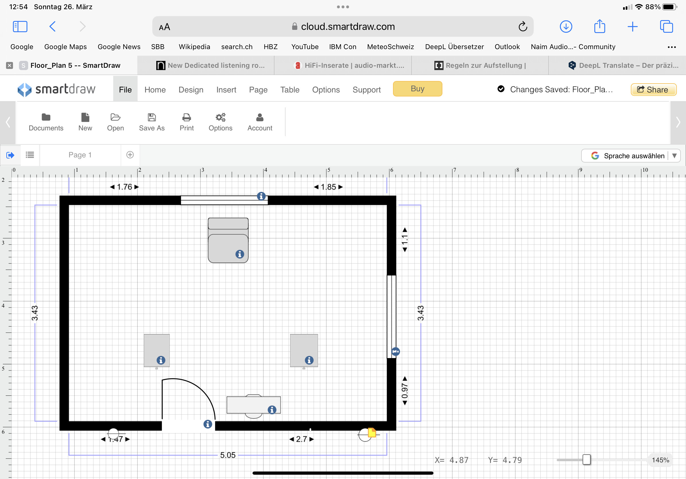

Yes, there are several options. In the drei photos you can see 3 scenarios.
A) Speakers and system on the narrow side by the window. Here the furniture would be easier. And I could use the existing power socket (marked door side right) and existing speaker cables.
B) Speakers on the long side. In this case, however, an additional socket would be needed to the right of the window in the middle. This would require an additional cable to be laid in the wall. Or a long hifi power cable would have to be laid in the room.
C) Speakers on the long side (turned 180 degrees). Existing power sockets can be used here. However, other speaker cables would be needed to bypass the door entrance.

Personally I would try and avoid windows on 1st reflection points ie both side walls and back wall. Glass on the front wall (speaker wall) is not bad providing speakers are about a metre or more away, however absorption will be necessary on the back wall to prevent the glass area forming a second reflection (albeit long). Fun and games :partying_face: Best Peter
PS. In a room the shown size I would definitely fire the long way enabling distance as mentioned above also respect of getting your listening chair 3 feet or so away from wall behind due to low frequency pressurisation issues :+1:t3:
