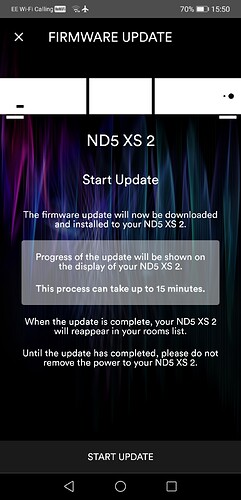

Tell me again where the progress of the update will be displayed :wink:

Naim tell me that this will be fixed in future to take into account the ND5XS2…
That little amusement aside the update process was very smooth indeed
