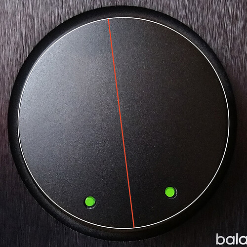

For those who are interested, this is a 2 photo montage of the absolute Start (Left) and absolute Finish (Right) positions of the balance control on my SN2. You can see the ‘mechanical’ centre of the balance will be just before 12 Noon / North, which is where after several tests, I have actually set it by ear. I have never had a problem at lower volume levels, and does the position bother me? Of course not !

Both Naim preamps I own came with the balance knob offset like that, one of which was a 552. There doesn’t seem to be much effort put into getting them central. On anything other than a 552 it is on splines and can be carefully pulled off the and put back in the central position. Care is needed because of the wires for the LED, which also have to allow for rotation. At your peril or get your dealer to do it.
Exactly the same here. Thanks for the photograph.
Hi @GeoffC, great pic, and mine would be similar if you imagine the green dots over to the left a little more and the red line just after 12 o’clock as opposed to just before 12 on yours. Not a problem with this whatsoever.

Hi @Stephen_Tate, yes I imagine it can be taken off and put on more centrally but to be honest it is not too far out so to me, just not worth bothering with.
