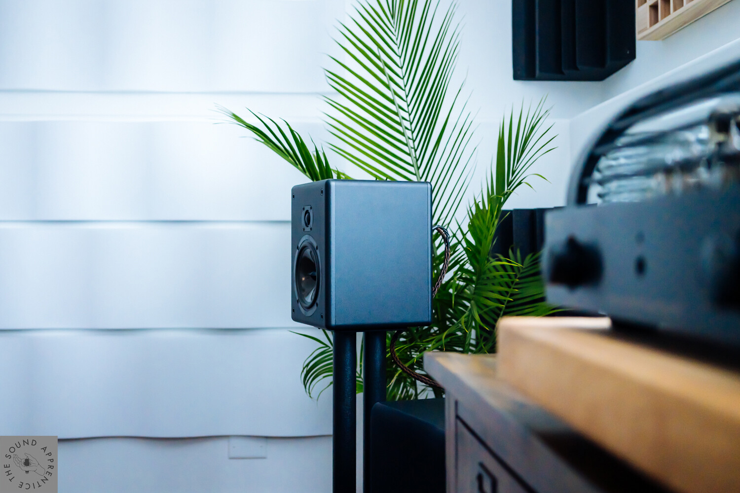

A variant of the Sumiko Master speaker setup method worked well and rather quickly for me in many different real-life situations. Google for it, there is a summary on the Sound Apprentice website. Instead of the music suggested there, I use a mono mix of Reed’s Walk on the Wild side because it has the double bass body as well its strings rattling against the fret board at a higher pitch, all in one placement, and being mono it has a strong, unambiguous center. The most important thing is that you know the music very, very well. This method shares some aspects to the Audio Physic method mentioned above. Other methods that are purely calculation-based may be preferable when planning a dedicated room, but IMHO the practicality of Sumiko and similar methods wins in existing rooms with shared usage.
Here’s a link to the system as used by the Sound Apprentice.
