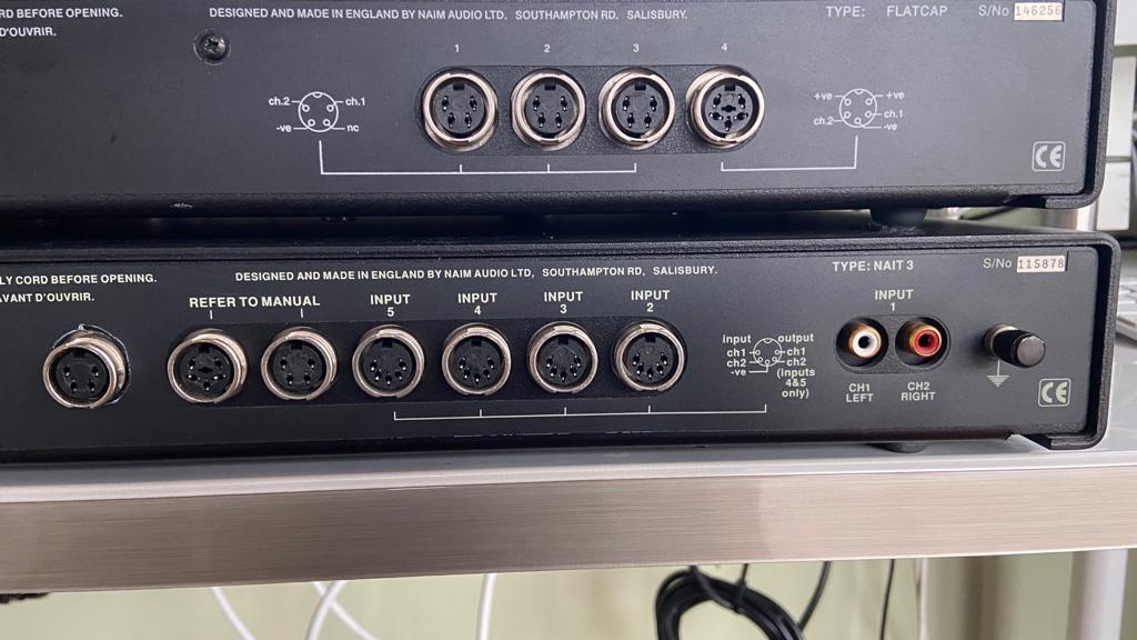

Q3) From the picture of the rear how do I connect the flatcap to the amp? There are so many sockets !
Q4) I guess the red and white inputs on the far right are for the Linn deck and then I just follow the front panel to see which input is the CD player and match that input on the rear

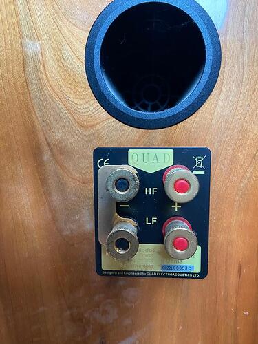

Q7) Which inputs do the cables go into on the speakers as they’re are 2 sets - one on top of the other

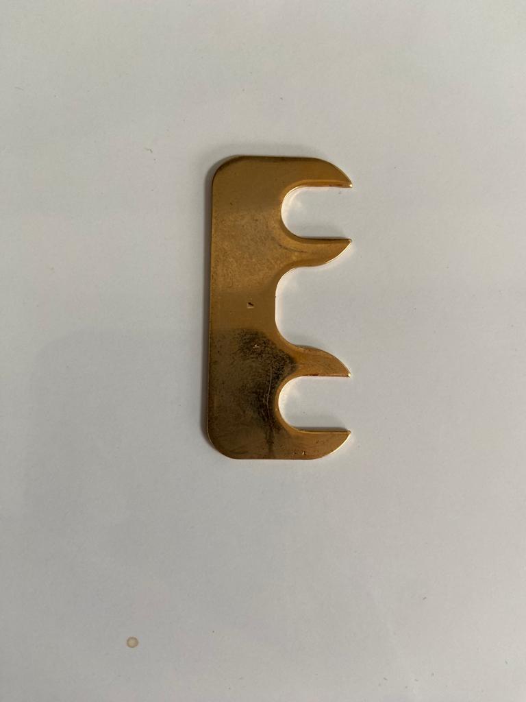

Q8) I think I might have to get another one of these as the right hand speaker has 2 and the left only one. Are they linking the HF inputs with the LF inputs. I presume Ebay for these or is there a specialised
second hand hifi equivalent.I also need to know what are they called apart from brass thingies (sorry)

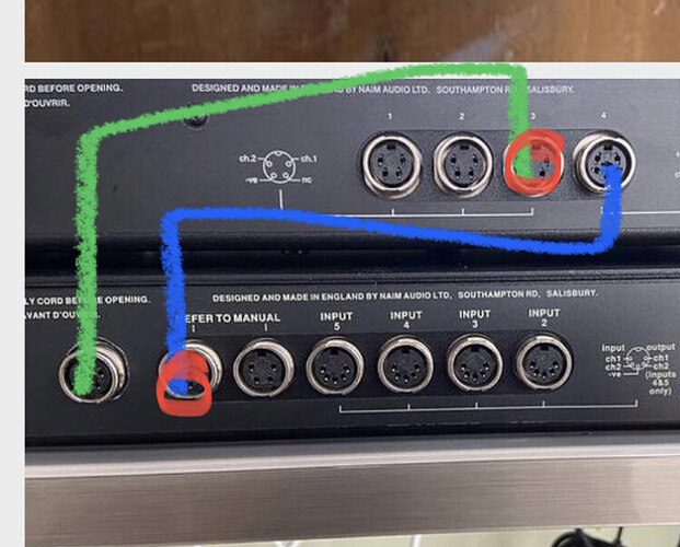

To connect the NAIT3 to the Flatcap you will need a SNAIC5 and a SNAIC4. SNAIC5 between NAIT3 and Flatcap - this provides power to the NAIT3’s pre-amp stage and signal then goes the other way from the pre-amp back into the Flatcap. Then signal from the Flatcap into the NAIT3’s power amp section via SNAIC4. The banded ends should go towards the source of the music signal.
I presume the NAIT 3 has phono cards fitted input 1, in which case, yes that’s where you connect the LP12.

7 & 8. The speakers are bi-wirable. That’s not such a great idea from Naim’s PoV so just run a single set of speaker cables into one or other of the red and bald socket pairs. You will need to have the links in place though, or else replace with short speaker “jumper” wires, which can be a performance improvement.

There are some pics and more info in this thread that should help. You can see a photo of the snaic 4 and 5 in place.
You’ll end up with this; the 4 and 5 pin dins will only fit into 1 of each pair marked. 4 on the left, 5 on the right. Red circles mark the banded ends.
The speaker shown in the photo has red and black plastic plugs blocking 3 of the banana sockets. You can ease these out with something pointy - just preempting a future question! To keep it simple, ease out the ones in the HF and plug your speaker cables into these. The LF will be connected either by the brass link plates or by a short bit of cable.
Robert_h.Thank you so much for your contribution and your time Could you explain what you mean by the “banded ends”
Richard, thank you. I will gen up on FAQ re: speaker cable and SA8. Just explain to me what you mean by the “banded ends” of SNAIC4 and SNAIC5 going towards the source of the music signal. Appreciated

The maker’s mark on a genuine snaic (it’s a number that denotes the person who made it) also identifies one end.
