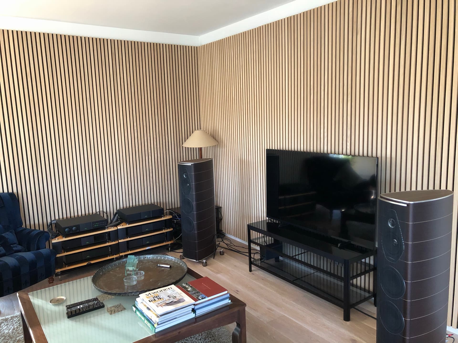

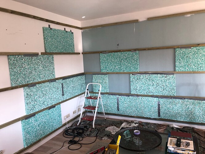

@Hifi_Naim_CNNL sure, you can definitely add wool behind it. I first made a frame (3cm by 3cm bars) on the wall. The WoodUps are mounted against that fraim. Before mounting, I put wool between the frames. I only filled 30% of the free space; this as per recommendation of an acoustic experts who did some measuring first. Filling everything with wool, would have made the room dead. He calculated 30% was the optimum.

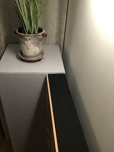

To illustrate air gap in placement against wall:

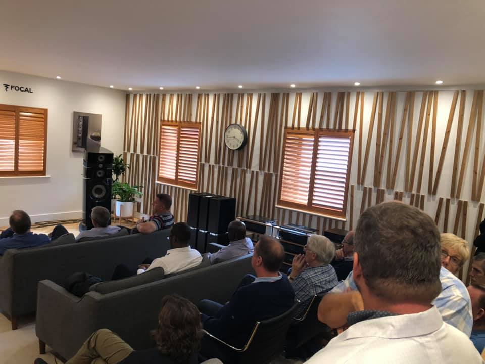

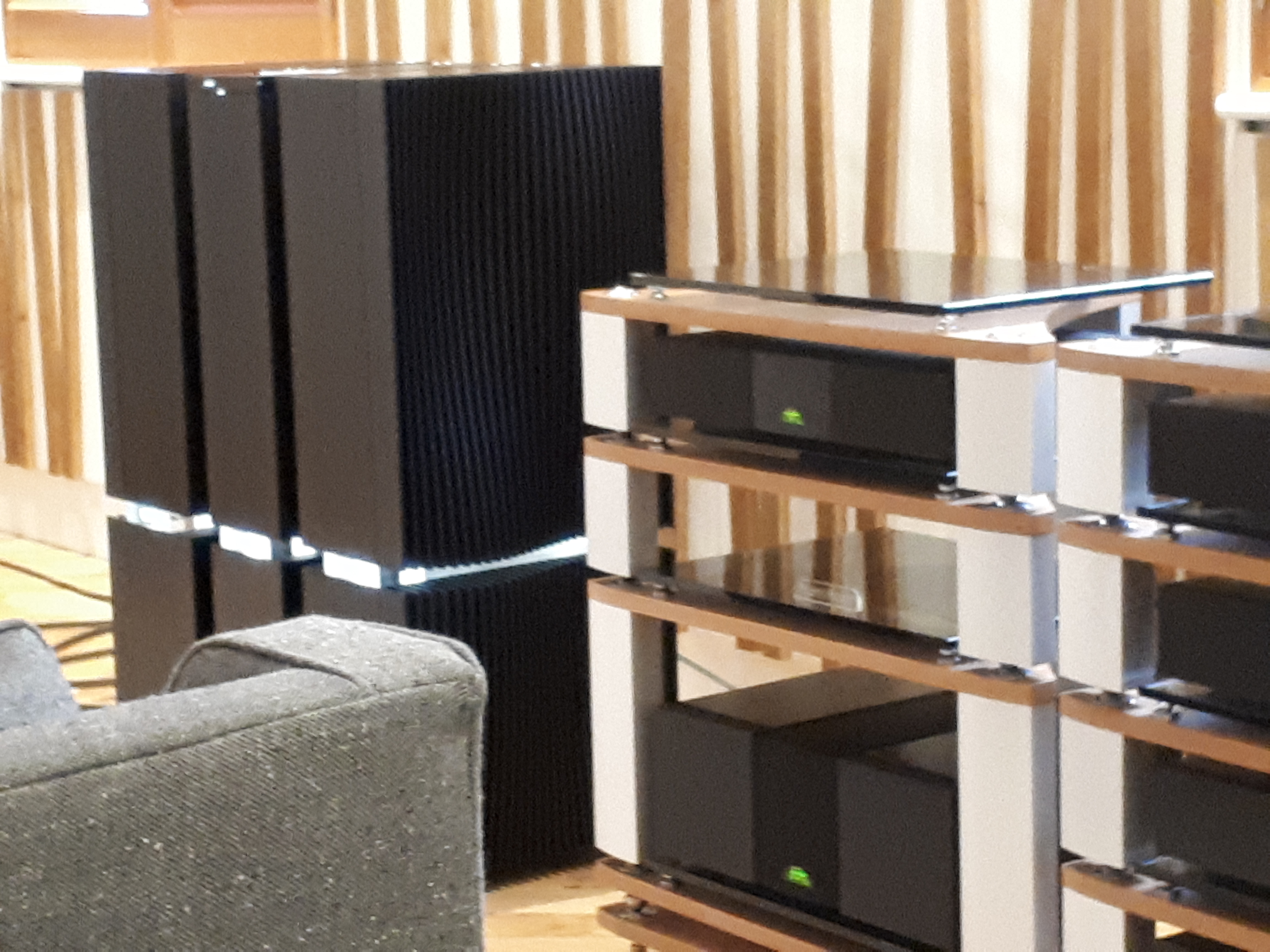

These Woodupp panel look similar to (but not the same as) the panels depicted in the photos of Naim’s own demo room.
The above thread notes that the wooden slats did improve the sound in the room and changes to the angle of the slats improved this further.
If wooden slats work for the Naim demo room then the WoodUpp slats may work in other rooms.

Hi @Hifi_Naim_CNNL ; the woodupp panels have a certain « absorbtion-capacity ». If that is not enough to your needs (like in my case), one can add additional wool behind the panels. I just went to a DIY and seached for wool specifically made for dound absorbtion. I think the brand I have is called Knauff but there are many others.
The measurements of the sound experts indicated I should foll 30% of the wall with this additional wool.

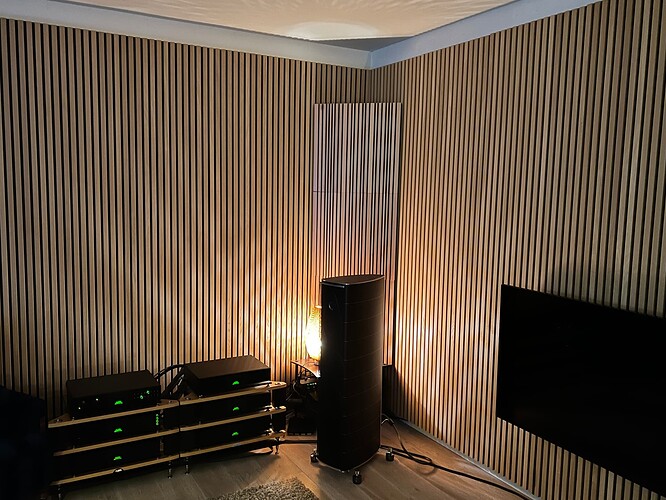

For the corners I also needed two basstraps. I found these (same color and looks like the WoodUpp) with Artnovion
Iver
Here is a oic that also has one if my ArtNovion basstraps in the corner. As yiu can see, colors align and the sound-result is impressive and very convincing to my ears

My preference in terms of looks were the WoodUpps though. So I got sample assets of WoodUpp allowing the engineer to redo the measurements and adjust his advisory plan: with alternative absorbtion of ArtNovion +/+ the WoodUpp we could get the same outcome. So this let my choose the latter. By the way, the frame on the wall for the panels is so thick I have a 1cm spare between the wall, and the background-wool so all set
