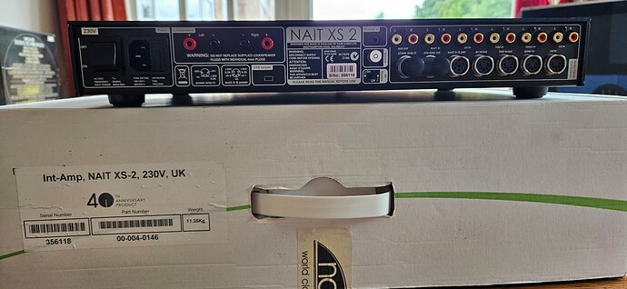

So I’m going to conclude that any XS variant with a serial number from 2013 and with ‘40th’ on the box is a ‘proper’ 70 watt XS2…probably :grinning:
Just to save any confusion, this was my XS -2 before i sold it on an auction site a while ago now.
Yes it is the 70w version complete with the box and 40th anniversary print :grinning:
