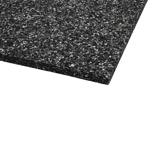

I tried to put 3 raw polyurethane panels like this one:
Suddenly I got a much bigger and precise soundstage which is fantastic. On the other side the bass seems too clean now. I can feel that the speakers still go down properly and that bass is more articulated, however it’s less punchy and engaging (both with music and movies).
In many Hi-Fi system photos some of you have put absorbing panels behind the speakers (usually with similar speaker height). What did you experience? Is there a suggested size to get a balanced result without exaggerating things? Or should I choose a less absorbing material? Also I wonder when this effect should be considered too much, I have no real comparison other than the experience with my own speakers. Quite hard to judge without a proper reference, so is it just a matter of taste?

My DIY acoustic panels do not influence the mids and highs, they basically absorb the lower end; these panels are commonly used to stop noise from coming inside a room and are installed under the floor or behind a plasterboard. Nothing refined but they do the job surprisingly well. My soundstage and mids seem to shine and are very clean. Have you considered using a different material other than rockwool? I also noticed that if the absorbing panel is higher than the loudspeakers, the mids get cleaner.

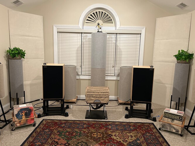

The bass in my room was slow and lacked definition. I used bass traps in the four room corners but bottom end was still unsatisfactory. The solution in my room was to add 16-inch ASC tube traps along the wall between the speakers. This added additional bass absorption and diffusion on the front wall–bass was tightened up and became much quicker and sound stage also improved. While there’s still some very- low frequency suckout at the listening position, this is vastly better than the slow muddy bass that previously existed.
