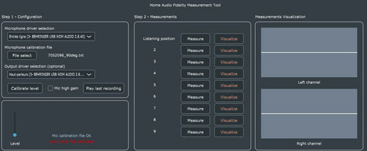

Going to the Home Audio Fidelity website there is a downland of a program that allows one to measure the room along with a download of the sound wave track to measure - which I downloaded and saved to my library so it was available in roon.
It’s a simple enough interface, connect the mic, open the program, calibrate the mic - basically hit calibrate and play the track.
My son lent me his mic stand and I’d recommend buying one if you don’t have access to one.
Windows being windows I did need to change the sound settings twice to use the UMIK1 twice and it worked the second time.

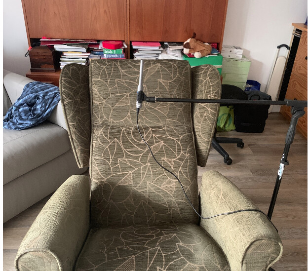

The next step is to take the 9 recommended measurements, the first at the main listening position (pictured) and 8 more 30-100cm around the sweet spot…

So when the measurements are taken they were stored on my laptop in a folder called HAF.
I saved these to onedrive and sent the link to Thierry in HAF. I also sent a song for Thierry to apply the DSP to so I can see what type of changes the filtering will producue before laying any money down.
