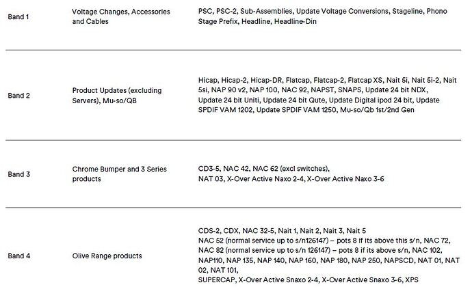

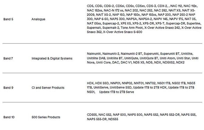

there’s a Service & Repair thread out there from last year - I recall asking some of the same questions. There was also a price list (2022) posted by Claire in Mktg (below)
There it is :point_up:
Good info, all the best
Martin
Try this.
